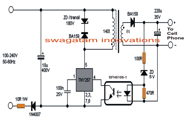

This is the reference diagram. I think we can do it just by increasing the secondary turns and modifying feedback loop. And also by adding constant current control circuit. And some other modifications?

1) I don't know how you are going to use the IC. Do you have a schematic?
2) Is this part in production? The data sheet is hard to find.
3) If you use the part in the way it was designed it would be "on" for about 50% of the time. So to get 400mA out (100%) you will need 800mA (50%) from the power line. Plus there is slope to the current so you will have currents of 1.2 to 1.5A.
4) If you use the part in a DC to DC mode......well the part will not work at high duty cycles. Example 80%

No. The chip has a current limit of 450 mA and a max duty cycle of 68%. Rather than "think" it will work, run the numbers and see.
Power Integrations has dozens of parts better suited for your application, and an entire section of their site is devoted to LED applications.

Yes, I have attached the schematic in the above post. The part is available here at a very low price and its the most famous IC in "Low Cost SMPS" designers.
That means I still can use it for more power than what is read to be max in the datasheet like for 250 mA current?
No. But it's better than other methods with least no. Of components.
