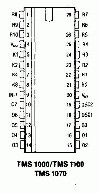

One Down 3 to go TMS1122 is a bugger to find info on.
It is a 24 hour Clock.
Here is the Datasheet for TMS1121

More Datasheets After Hours of Searching.
