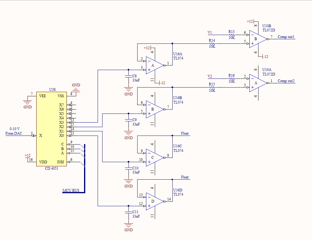

I figure out that the opamps in my circuit get very hot, The circuit is simple : 4 unity gain buffer using TL074 (-in=>out). The circuit has its normal electrical function but when I touch the chip surface I can feel a high temperature that is not normal to me. I have several instances of the same design on the PCB with the same behavior.
It is really strange because I moved my design on bread-board using DIP version of TL074 without any heat problem. The only difference now is that the SOIC version of TL074 is soldered on a well grounded PCB! I use +/-12 v on the rails + 100nF cermic caps close to the chip power pins.
Any difference between the DIP and SMD package of TL074?

The circuit is actually a Multiplexed DAC + S&H stage , Here is the schematic:

Despite your precautions with grounding and power-pin caps it's possible there may be circuit oscillation. Can you check with a scope ?
I checked it with scope, there is only a 5mVp-p AC ripple at the output stages which I think is a portion of power supply ripple. it does not sound like oscillation.
How an oscillating/unstable opamp should be ? Can it easily be traced with scope?
I planned to move from SOIC package to TSSOP due to size limit of my PCB. With my experience with SOIC I think a TL074 in TSSOP package will melt my PCB.
I saw the datasheet of a Japanese (Toshiba?) copy of a TL074 where they made it "better". They made it oscillate at a high frequency which made it hot. They recalled and replaced most of them. Maybe you have a bad copy. Use an American TL074.
A TL07x will oscillate when its output directly drives the capacitance of a couple of feet or more of shielded audio cable. It is fixed by adding a 100 ohm resistor in series with the output of the circuit so that the resistor drives the cable.
