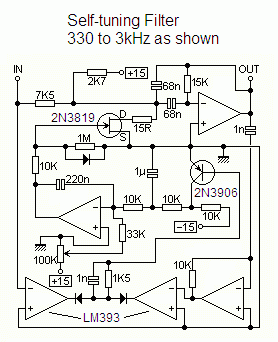

Hi Dr. EM,
You might be interested in this self-tuning filter. I don't know what the pot does:
Hi Dr. EM,
The self-tuning filter would do the opposite of fuzz, it would make a guitar sound nice and smoooooooth. A velvet guitar, something like a flute.
It would probably make your voice sound restricted like a very bad telephone connection. :lol:
Oh right, thats pretty cool then. Would sound nice with a good reverb after it i'd imagine. Does it re-tune on different incoming frequencies, or levels?

Hi Dr. Em,
I think the filter will follow the frequency of a single input. If you feed it a chord, it would probably get confused and who knows what it will do.
