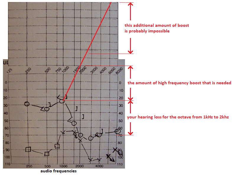

See old and new volume settings. See attachment of hearing test.

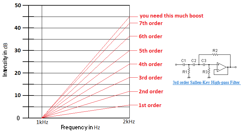

You have the results of your hearing test that shows that the high frequency boost is needed only above 1kHz so why does your circuit have six frequencies?
Your filters have six 10 ohm resistors in parallel with an earphone or a pair of earphones. Then if the earphones are high impedance 600 ohms, the load on the TL071 opamp is 1.7 ohms. But the datasheet for the opamp shows a minimum allowed load of 2000 ohms.
Your filters will do nothing because they are all in parallel. If the resistor and capacitor values of one filter are 200 times or more higher and it has a high impedance load like the input of a power amplifier then it would cut low frequencies only gradually because the filter is not active (it is passive) and it has only one capacitor and one resistor (1st order).
Your hearing test shows a high frequencies dropoff at 45dB/octave. One RC drops off at only 6dB/octave. Then your highpass filter (or high boost circuit) needs 45/6= 7.5 identical RC circuits inside the negative feedback loop of an opamp. A complex 7th order highpass filter.

One of your ears hears nothing and the other does not hear anything above 2kHz so a hearing aid needs a miracle to give you hearing. My digital hearing aids have a program option that takes high frequencies from 4kHz to 20kHz and converts them down to 1khz to 4kHz. The audiologist did that on my hearing aids and asked me how I liked it. It sounded AWFUL and I asked for it to be turned off but you might like it for your best ear.

Here is a graph showing one RC 1st order highpass filter up to a 7th order and how much boost at high frequencies you need. I show the schematic of a 3rd order Sallen-Key active highpass filter.
The tone controls circuits you found have a very gradual amount of boost as a 1st order passive filter. The equalizer circuits boost with about a 2nd or 3rd order filter. You need a 7.5th order filter. You need a lot of boost beginning at ONE frequency, 1kHz.

Gary, you need only one highpass filter that boosts beginning at 1kHz and at 45dB/octave. Your hearing test clearly shows that for your "good" ear.
As I showed, you need a 7th order highpass filter. I showed the schematic a 3rd order highpass filter.
The tone controls and equalizer circuits that you do not need have no gain so a mic preamp circuit is needed to feed them. The tone controls and equalizer circuits are for people with normal hearing to make small corrections on the sounds from cheap speakers. Your severe high frequency hearing loss in your "good" ear needs one extremely high correction beginning at 1kHz for 45dB/octave.
You posted a horrible equalizer circuit from eleccircuit.com (in India?) that I think does not work.
Here is your hearing graph and what is needed to fix only a little bit of it:
