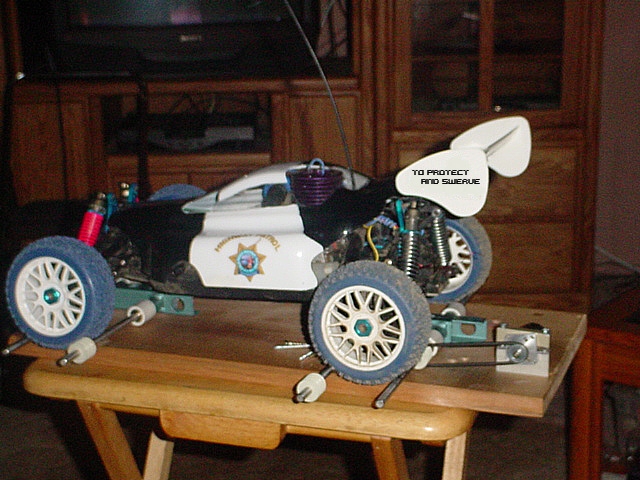

I can assure you, systems like the AMB use RFID technology. I know this because I use to be a member of an RC club. We purchased a system from AMB and were told by the reps that it used RFID for the transponders, and it worked well above 10mph. I raced a Ofna Buggy, see pic :)
