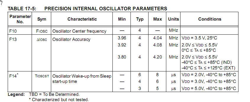

Can someone tell me which clock I'm using if i select the internal oscillator for the timer. Is this the oscillator included in the chip, or is this oscillator from which the microcontroller is already running (I'm already using an external oscilltor). Also, how accurate is the internal 4 MHz oscillator. Is it very poor like the 32k, or is it ok?
If you are using a 4MHz xtal then the internal clock to the timers is 1MHz.
What sort of timing accuracy are you looking for.?
Ok so it runs off a 1MHZ internal osclliator which comes from the external source?I was looking to achieve at least +-5%. I'm assuming that this is ok now if the clock comes from the external source?
I think you have misunderstood, the external crystal , 4MHz in your case, is automatically divided by 4 by the PIC, so that the PIC's internal clocking rate is 1MHz.
EDIT:
Yeah, that sort of what i was getting at. i've got one final question if anyone knows the answer. How do i get the counter to rest and continue to periodically interrupt the program?
