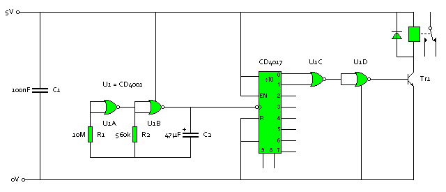

Hey guys its summer here and temperatures rising as high as 43 degree celcius.. coolers are out. i have a simple plan in mind for saving energy and water usd for coolers. ours is a cooler using 60 L of water in 4-5 hrs. and the water is carried on from a lower tub to an upper tub for draining it on to a special grass fixed on the walls. now this requires a pump of 50 watts at least. and it consumes more energy and water if running continuously. so i am thinking of designing a circuit that would switch the pump on for 2-3 min every 15-20 min. at other thimes it would be off. any ideas??

The CD4060 can be used as a timer.
how could we program it for 10 min break and then 2 min working? solar power would be too costly to use. moreover we need cooling for 8 hrs a day. the total energy consumption is 1300watts per hr, so solar power is a costly option initially. it would need a heavy inverter and a powerful battery. so if we just control the water pump we could save a lot of water and energy. also after every 2-3 hrs we turn of the cooler for 1 hr.
I have another idea: a CMOS oscillator and a CD4017 counter.
C2 needs to be a low leakage tantalum capacitor.

I've just realised that C2 needs to be non-polarised.
Fortunately it's easy to make a non-polarised capacitor by connecting two capacitors back to back, the diodes might not be required for tantalum capacitors which tolerate reverse voltage quite well. You might even be able to get away with using a single tantalum, check the data sheet for the reverse voltage rating. If the diodes are used they should be low leakage.

how should i actually proceed? i am a newbie and have no ideas.. from 4017? what could be a good design?
I've given you the circuit, what don't you understand?
The 5V can come from a mains adaptor. The power doesn't need to be regulated though so it could just as easily be a 6V adaptor. The relay is used to switch the pump motor which I assume is mains powered?
