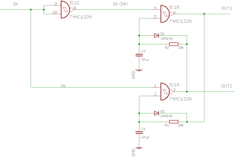

Would something like this do it? I checked and think it would, but I'd rather check with you:
Yep, that's using negative logic for the "or" function but should work just the same - plus the advantage of the schmitt trigger gate inputs.
I'd connect the RC circuit input just to the other input of the same gate, rather than the opposite output, but it will probably not make much difference.
Either way, add a resistor in series with the diode as otherwise the signal feeding that will be delayed by the capacitor charge (or discharge) current; eg. 4k7
You could also use rather higher value timing resistors and smaller caps, on the CMOS inputs. Something in the 100K to 1M should be fine. eg. 470K and 1uF would give the same time constant.
That minimises the charge time through the diode and its resistor while still allowing a long off delay if needed.

Great, thanks for your input! I keep you posted with oscilloscope readings of the result.
Is the use of out1 to in2, out2 to in1, not a safer way to obtain the desired result: interlocking?
