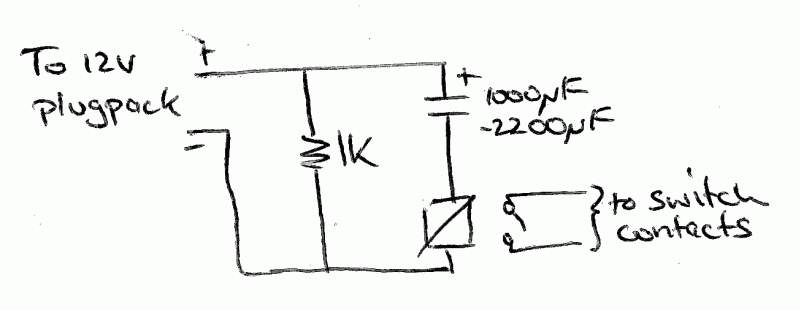

The project I would like some advice on is a timed switch to open my garage door opener at a time in the morning and close at a time in the evening.
The door can be opened manually by a door bell type button push once to open then push once to close I would like a circuit that would utilise this, using an AC digital timer with a socket would seam to be the most convenient way of timing the switching, plugging a suitable transformer the power supplied could be a low DC say 3v the part I need help with is a simple circuit to

The answer to your questions I do have a mains electronic timer 7 day 8 on off settings, the shortest timer segment is 1 minute as for any voltage on the button wires I have tested both wires with my tester set to DC v and the only figure I could read was on the red trace wire which read 00.4 these 2 wires are only bell wire and they go to the circuit board the terminals are marked 1 and 2 number 2 is red the red trace wire is attached. the answer to your last question, my idea was to plug into the timer a transformer something like an old phone charger I have lots of these typ of transformers ranging from 18v dc to 3v dc the timer would turn on the transfotmer and the dc volt would operate a switch which would connect the 2 operating wires and start the motor, the timer would turn off when the power stops the switch resets until the timer turns on again, the time the motor runs is adjustable in the motor housing. The only thing I am unsure about is if the wires are kept connected for the 1 minute the timer takes to switch off, if I used a switch which reset after 2 or 3 second would it be re trigered because the power would still be present. I hopes helps you
You can use a relay to connect the switch contacts together. The relay can be powered from the plugpack and the ON-time controlled by a series capacitor. The resistor shown in the diagram to to allow the capacitor to discharge when power is removed (you should probably use a 10k rather than the marked 1k).
The time the relay is on is determined by the value of the capacitor, but also by the characteristics of the relay; therefore you may have to try some different capacitor values to get the time you want. 1000uF-2200uF should be a good starting point for a few seconds of operation.
