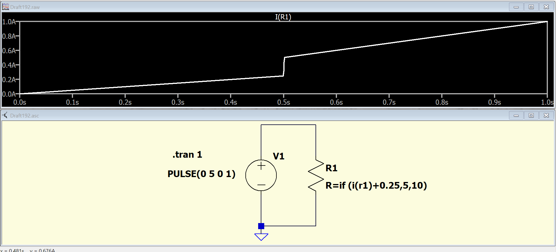

Here's an example for varying resistance on the fly, as a function of current. The expression for R would need to be much more complex (more 'if' clauses) to handle the various alapha values :
