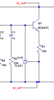

Do you know how I can get this simulation working?, it gives the above error.

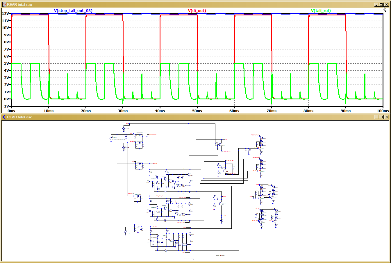

It work for me,
Goto Tools/Control Panel,,, select Alternate NOT Normal
E

tried alternate 1 and 2, and runs for a bit but then stops and gives the error...I am using windows 8
I am using XP Pro.
You didnt add the TLV431_ti model to your file so I used my TL431, it should be the same.
Could your TLV model be the problem.?

The tlv431 model I used is from Helmut sennewald on the ltspice forum, as attached
the model worked fine in other sims with less nodes.

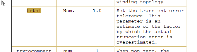

With your model and Trtol=1 it never solves the sim!, change Trtol = 7 [ on the same Tools window as 'Alternate]
It runs slow but it will solve
E
EDIT:
Sometimes it fails! There is a problem with your model
