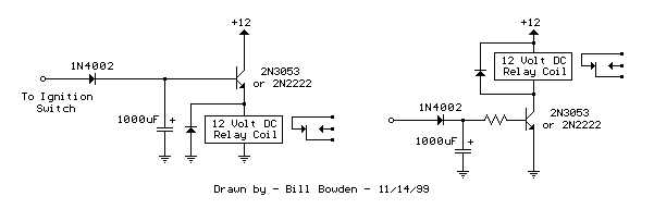

OK, this could be done with a 555 circuit but I have a real simple suggestion that may work. See the attached few circuits. Here is the description:
Description
The two circuits above illustrate opening a relay contact a short time after the ignition or light switch is turned off. The capacitor is charged and the relay is closed when the voltage at the diode anode rises to +12 volts. The circuit on the left is a common collector or emitter follower and has the advantage of one less part since a resistor is not needed in series with the transistor base. However the voltage across the relay coil will be two diode drops less than the supply voltage, or about 11 volts for a 12.5 volt input. The common emitter configuration on the right offers the advantage of the full supply voltage across the load for most of the delay time, which makes the relay pull-in and drop-out voltages less of a concern but requires an extra resistor in series with transistor base. The common emitter (circuit on the right) is the better circuit since the series base resistor can be selected to obtain the desired delay time whereas the capacitor must be selected for the common collector (or an additional resistor used in parallel with the capacitor). The time delay for the common emitter will be approximately 3 time constants or 3*R*C. The capacitor/resistor values can be worked out from the relay coil current and transistor gain. For example a 120 ohm relay coil will draw 100 mA at 12 volts and assumming a transistor gain of 30, the base current will be 100/30 = 3 mA. The voltage across the resistor will be the supply voltage minus two diode drops or 12-1.4 = 10.6. The resistor value will be the voltage/current = 10.6/0.003 = 3533 or about 3.6K. The capacitor value for a 15 second delay will be 15/3R = 1327 uF. We can use a standard 1000 uF capacitor and increase the resistor proportionally to get 15 seconds.
Obviously the part labeled "Ignition" is from 12 volt power that goes away and the power to the relay is always present. This could be 5 volts using a 5 volt relay or whatever you come up with. I won't swear this is a solution but for a few parts it may be worth trying and modifying.

you read my mind in a way. i had thought of a small relay acting as the switch, i just wasn't sure of how to keep it on for a time then allow it to shut off. so the capacitor acts as a temporary battery in the circuit to keep the relay on, then once it gets to low the relay shuts off?
Sort of, the cap slowly discharges through the transistor when power is removed keeping the transistor on which keeps the relay pulled in. Once the cap discharges the relay opens as the transistor turns off. It's a simple little circuit to mess with rather than moving into a 555 timer circuit.

I have made your circuit (the second one, on the right) using a 4700uf capacitor, 50K trimpot and a 1N914 diode in parallel with the relay coil contacts.
I cannot seem to get the circuit to work. I can get the relay to trigger if I connect both the input of the 1n4002 and the collector to 12v but there is no time delay.

The "+12V" input must remain connected to live 12V power AFTER the other input is disconnected. Bowden's circuit is naive, to say the least.

Sorry. I figured out soon after posting that I had been given the wrong data sheet with the transistor, showing the E,B,C the opposite way.
I have replaced it and now have it placed correctly.
The circuit works, though as predicted with only a short delay.
I can adjust it with the pot until about half way after which it won't trigger anymore. The only way it will trigger again is if I turn the pot down below about half....

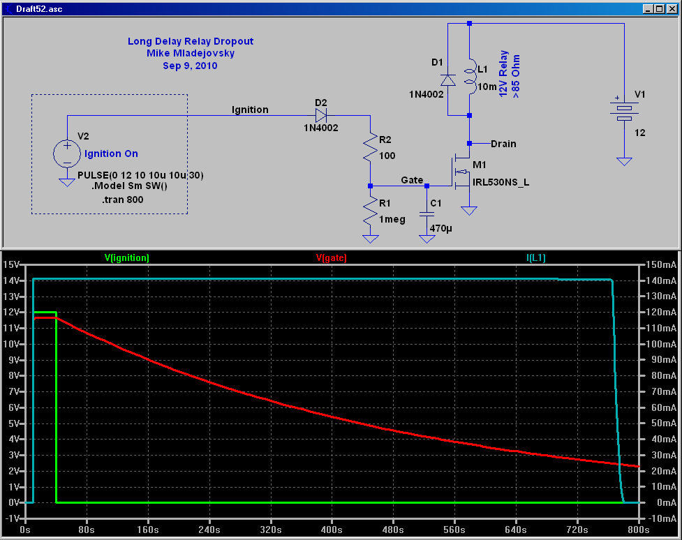

This will give you a long delay after the ignition switch is turned off. The NFet is not critical. Anything >50V Vds in T0220 package will likely work. I use a similar circuit to automatically turn off the Ham rig in my car. I also have a momentary push switch from +12V to the cathode of the diode so I can start the timer without putting the key in the switch.

Tried the circuit as suggested. Used a P16NF06, 2x 1N4004's and an electrolytic cap. I believe pin 2 of the MOSFET to be the drain – Is pin 2 also connected to the tag? Thanks for the circuit. I am getting around a 6min delay..
Now a few questions....:D
What is the best method of extending the circuit (pot?) to around 10 mins (or shortened also)?.
What is the overall potential timing range?
Is there any potential for fire etc.. if the circuit is insulated (Will be used in a new vehicle!) ?
You mentioned a momentary switch to the cathode side, obviously it was D2 you were referring to?
Does repeated switching (in quick succession) affect the circuit?
What would be the best way to reset the unit (drain capacitor to release relay)?
Ds.
...Used a P16NF06, 2x 1N4004's and an electrolytic cap. I believe pin 2 of the MOSFET to be the drain – Is pin 2 also connected to the tag?
Middle pin on TO220 Mosfets is the same as the tab.
The delay is proportional to the product R1*C1
Allowed range of R1 is 10K to ~5megΩ. C1 can be uF to mF.
Run it through a ~1/4A fuse on the "always live" connection to the battery (not counting load being switched, fuse that separately). No fuse is necessary on the "ignition switch" connection.
Yes, a momentary push switch from "always live" to the junction of D2 and R2 will pump-up the RC network for a new cycle.
No, each contact closure to R2 just recharges the RC network all the way...
Use a momentary push switch to ground the junction of D2 and R2.
