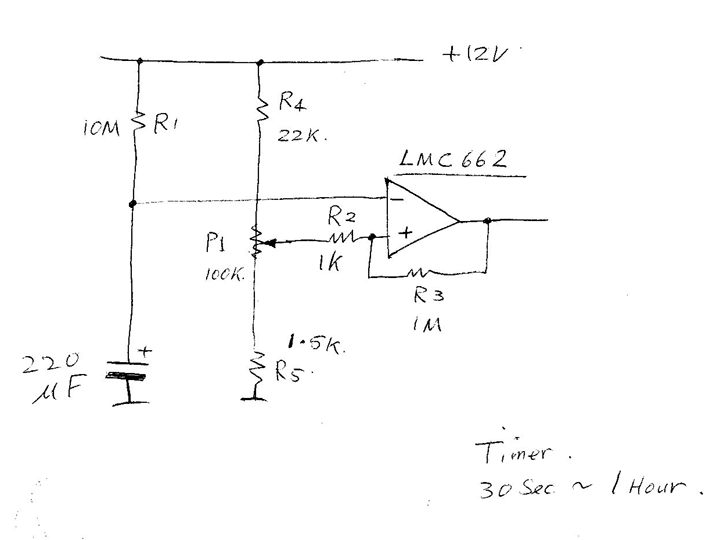

I am looking to make a Circuit that when you push a button it will activate a relay and a timmer. and when the time runs out it will close a relay.
I would like it to be adjustable with a pot for 0-60 min. let me know if you have any ideas. I was going to us a 555 timer but i was told it will not time for 60 min.

The CD4060 and CD4541 oscillator/timer ICs will easily time to a hour with a small and inexpensive capacitor.

The 74393 is a dual 4-bit binary counter. They are pretty cheap. All you need is a couple of these and a 555 timer.
A CD4060 oscillator/divider is only $.48US at Digikey.
A CD4541 is only $.55US.
They don't need a 5V regulator like old TTL needs.

This can be done with 2 ICs. A counter and a Quad NAND Schmitt Trigger.
The Schmitt can be used for the power on reset and the oscillator.
Operate the relay when Q14 goes high. Connect one gate of the Schmitt as an inverter and connect it between Q14 and the other input of the oscillator gate to stop the oscillator. While Q14 is low, the oscillator is allowed to count. When Q14 goes high, the oscillator stops.
If you don't understand this, let me know and I'll post a circuit. Don't forget to insert 100 nF bypass capacitors on the supply line.
The CD4060 oscillator/divider IC need a resistor and a capacitor to reset it when power is applied.
The CD4541 oscillator/divider automatically resets itself when power is applied.
Why use a counter IC plus a gates IC?
1. I prefer to use a Schmitt for the power on reset for the 4060.
2. I have not studied the 4541, so I did not realise it has internal power on reset. That's good to know.
Here is a suggestion as requested in your PM
