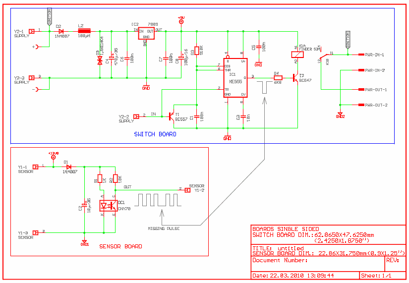

I am building a remote start alarm . And i need to build a device that sends dc power at the firsn ignition cycle and then cut off using a pulse with modulelation fron the injector. To crank the engine. So that every time that i cycle the ignition it will give power to the starter circuit and then cut off as soon as the engine starts. Any ideas as far as what (micro controlers, pnpndiondes,capacitors, or devices that i can can get at a local radioshack.?

I really apreciate ur comment. Do u have any ideas as far as what commponents i can use to develop the project. I know is hard to develop it but am willing to spend the time on it. I was tinking it will be easier to create a divice that can send power at the firts ignition cycle and being able to regulated . Lets say my emgine takes two seconds to start then to be able to regulate the device's output time and adjusted to two seconds or if it my motor takes tree seconds or more being able to regulated for the amount of time i need to start the engine. I doesn't have to detect when the engine starts instead i can just regulated with a simple potensiometer.. Mi bigest issue is the cranking time. I have igniton power to the engine once i recive the signal from the remote i just need the control cranking time .. Any ideas..

Hi Jose,
here is an idea which might work. It has not been tested.
Function: A reflective IR-sensor measures engine rpm. It puts out a square wave signal according to engine rpm.
At e.g. 600 rpm the output is 10Hz (600rpm/60) for single point sensing. The CNY70 has a focussing distance of max 5mm. Using a white mark on the crankshaft rpm will be sensed reliably.
The receiver is a monostable multivibrator (NE555) acting as missing pulse detector. As long as the pulse recurrence frequency is below time out the output is low. It turns high at a frequency of 10Hz and above.
The values given in the schematic are valid for single point measurement at 600rpm (timing ~100ms).
The connected relay switches the starter relay via terminals COM and NC.
To activate both circuits voltage must be supplied when turning on the ignition key. This activates the starter immediately.
When engine rpm is high enough the starter is deactivated (relay switches COM to NO).
Here is the schematic of two PCBs, one "switch board" and the other one "sensor board".
Also attached are PDF files of both, schematic and PCB layout. The boards are single sided with one wire jump on the switch board.
Regards
Boncuk
P.S. Power is applied to the switch board only. When using the three terminal connector of the switch board and connect that with the three terminal connector on the sensor board power is automatically supplied to the sensor board.

thanks. i apreciate ur information but sice motorcyles don't have crannkshaft pulleys ist hard to aply this componet to thsi project but i,ll kip it on mind for fueatures adjustments for cars. i was thinking may be usinga a 555ic . can i make a 555ics to send a timer output for x amount of second lets say two or tree regulating it with a potenciometer. using inition key . but i need for the power to be send only once. on every cycle. lets say i put key foward with a device and that ignition cycle is gonna stay on as long as the engine is running but i need a time delay. i want to regulated with a potentiometer for the amount of seconds that mi engine takes to turn on. so the key is gonna be foward with the remote control but i need a output of x amount of seconds that only work every key cycle . is thera a way to do this with a simple 555 ics

as already said in the latest PM using timing is not the best idea.
A cold start requires some cranks of the engine to start while an engine at operating temperature will start with the first crank. Having the starter motor still engaged will lead to damage.
Although it's a motorbyce engine there should be a way to drill a small hole (3.5mm) into the crankcase to place the IR-sensor on top of the flywheel.
Boncuk
