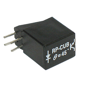

I've got a super-simple application where I need to turn on an LED when a small project box is in a vertical position and have it turn off in a horizontal position.
Currently, I have the LED wired to a battery via a rolling ball vibration and tilt switch that I picked up at Mouser (https://www.mouser.com/Search/Produ...010-EVvirtualkey12040000virtualkey107-2010-EV)
It's all just hand wired together since it's so simple, but my problem is that the ball switch is too sensitive and breaks the connection with even the slightest vibration. I love it because it's so compact (about the size of an axial electrolytic cap), but other than that it's not doing what I want. I'm sure what I bought isn't the proper component to be using, but without trial and error I'm having a hard time finding the right one. In my mind I want a mercury switch in the same form factor, but I don't want to use mercury in this.
I also thought I could use the same tilt switch to trigger a timer or something that turned on the LED, but that adds build complexity that I was trying to avoid. If I have to do it, that's fine, but I'm hoping I can find a different component that does what I need.
So, anyone have any thoughts on a more appropriate tilt sensor?

Another idea is to do it with an LED and photo transistor.
Start with a hemisphere and make your optical path oriented vertically right down the center. Put a ball in it 1/4 to 1/3 the diameter of the sphere. The optical path will be blocked when the ball is near the bottom of the sphere. Control the angle of response by choosing the ball to sphere size ratio. Add some mineral oil if needed to dampen vibration.

I have a few of these https://www.goldmine-elec-products.com/prodinfo.asp?number=G16881 and they are not as sensitive as the one you describe.
