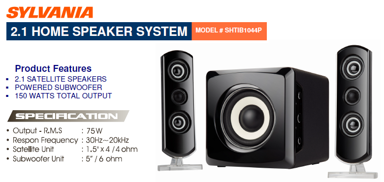

I use an American (not a Chinese) Name Brand (Sylvania) powered 2.1 speaker system for my computer and TV. Its ad says Total Output= 150Watts, and RMS= 75W. But inside it has two little class-AB amplifier ICs with little heatsinks glued on top and a small transformer that is labelled "9VAC/1.1A" (9.9VA). It probably heats with 4W so its actual total electrical output is only 6W. I figure each satellite speaker gets 1.5W and the woofer gets 3W. I like it and it sounds good. It costed $25.00.

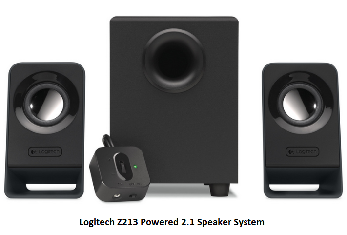

My neighbour was going to throw away computer speakers and asked if I want them. He paid $45.00 for (Chinese) Logitech Z213 powered 2.1 speakers. The box says, "Full Deep Bass, 14 peak". They sound awful with the woofer resonating at about 120Hz and the tweeters screech like car tires. The tweeters are modulated by the mains AC whenever the woofer is active so I thought the long cable from the speaker and its power supply to the on-off switch has too much resistance so I wired it to be always turned on, it made no difference so I doubled its total power supply capacitance to 4400uF and it also made no difference.

You get what you pay for! In this case $0 gets you ...?
I think the Logitech (hey, it is Swiss, not Chinese but is made in China like everything else) speaker system was made as bad as that since it doesn't have distortion. Its frequency response is all over the place with boomy upper bass, no deep bass, peaking upper midrange and a missing crossover network to keep the bass away from the tweeters. They make and sell that junk and people buy it without knowing how bad it is.
