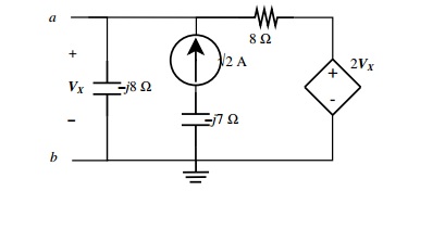

How would one go about determining the Thevenin resistance in the following circuit? Would it be correct if I turn off the 2 A source (thus it becomes an open circuit with no current flowing through) and then use nodal analysis to determine the in going current and then use it to calulate R(Thevenin) using Ohm's Law?
What would the answer be?
Thanks in advance

Same way you always do it: Calculate the open circuit voltage from a to b. Short a to b, and calculate the current.
I'm puzzled by your diagram.
Is the current source = square root of 2 = 1.414sin(wt) ?
Is the voltage source = 2sin(wt)?

Hi Mike
Yes, the current source is square root of 2. However I think the voltage and current source is a cosine function as it is a real number or am I incorrect in my assumption?

Since no phase shift between the current source and the voltage source is indicated, I would assume that they are both either sin(wt) or cos(wt); not one of each.
JeanTech,
"How would one go about determining the Thevenin resistance in the following circuit?"
You mean impedance, because there are reactances involved.
"Would it be correct if I turn off the 2 A source (thus it becomes an open circuit with no current flowing through) and then use nodal analysis to determine the in going current and then use it to calulate R(Thevenin) using Ohm's Law?"
If all the sources were independent, then you could say the Thevenin impedance would be 8 ohms of resistance in parallel with 8 ohms of capacitive reactance. But the Thevenin and Norton methods by themselves are invalid for circuits with dependent sources. The combination of Thevenin-Norton does give the correct equivalent impedance. See the derivation of Voc and Isc in the attachment. Notice that the Thevenin impedance is negative, which means that if you apply a positive voltage to the circuit, the circuit will try to push a current into your voltage source. This is due to the counter voltage produced by the dependent voltage source.

Well, the first thing we note right away about this circuit is that we have a lot of stuff in parallel. The only things not in parallel are the 8 ohm and the 2Vx dependent source. However, if we replace the 8 ohm and 2Vx source with it's Norton equivalent, we end up with everything in parallel. Then we can use a well accepted theory of applying a non zero excitation voltage or currrent, calculating the opposite quantity, then dividing voltage by current to get the resistance or impedance.
To see how easy this is for this circuit, lets look at the currents through each element after we make the transformation of the 8 ohm and 2Vx source to a parallel Vx/4 current source and a parallel 8 ohm resistor when excited by a 1v voltage source. Note also that the second capacitor does not matter because it is in series with a current source.
From left to right, we have first the -j8 ohm load and the current is:
-1/8j amps, which comes out to j/8 amps, so i1=j/8.
Next we have the sqrt(2) amp source, which is of opposite polarity so we have:
i2=-sqrt(2)
Next we have the 1/4 amp Norton current source, which is also opposite polarity so we have:
i3=-1/4
Next and finally we have the parallel 8 ohm Norton resistance, so we have:
i4=1/8
Now we add them all up:
iTotal=i1+i2+i3+i4=-sqrt(2)-1/8+j/8
Since we used a source of 1v for the calculation, we divide to get the impedance:
Z=1/iTotal=1/D, where D=-sqrt(2)-1/8+j/8
Now since there is an imaginary term in the denominator, we calculate the conjugate of D:
cD=-sqrt(2)-1/8-j/8
and calculate the denominator of the impedance Z by multiplying cD times D:
ZD=cD*D=65/32+1/2^(3/2)
and the numerator of the impedance Z by multiplying the voltage times cD, and since the voltage was 1v we get:
ZN=cD
as the numerator.
So the impedance is:
ZN/ZD=(-sqrt(2)-1/8-j/8)/(65/32+1/2^(3/2))
and simplifying this and converting to an approximate floating point representation we end up with:
Z=-0.645426-0.0524152*j
as the complex impedance with each part rounded to 6 significant digits.
MrAl,
Two questions for you.
1) Why don't you get the same answer as I do?
2) How would you calculate the impedance of the circuit if 2Vx were an independent source?
Ratch
Hello Ratch,
Well, i may be making a mistake here. It looks like we have to calculate an equivalent Thevenin voltage source and equivalent Thevenin series impedance. Thus the impedance might change with input.
But what really bothers me is that the circuit has positive feedback, and with a,b open circuit and the sqrt(2) current source being the only excitation, it looks like what may happen is the current source causes current to flow through j8 ohm and 8 ohm, until Vx across j8 ohm rises slightly, at which time 2Vx rises two times as high causing more current to flow into the node at 'a'. That in turn causes Vx to rise even more, which in turn causes 2Vx to rise more, and so on and so forth until node 'a' reaches either a vary high value or infinity.
So my question to you is, how did you calculate the open circuit voltage, and was that at node 'a' ?
I went over your inset in your other post but it was not that clear because for example you have a current on the left side of an equation or transformation and a voltage on the right side, which doesnt make sense in itself, but im sure you have an explanation.
So please state how you calculated the open circuit voltage for this circuit, and try to explain it as clearly as possible. We can then move on from there.

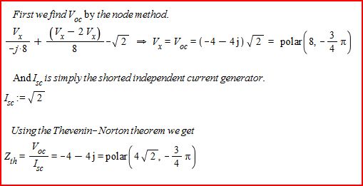

Just so we are on the same page, we want to find the impedance across terminals a-b. If the circuit contained only independent sources, we could just zero out the voltage sources, open the current sources, and calculate the Thevenin impedance directly. But because of the dependent voltage source 2Vx, neither Thevenin's or Norton's theorems works by itself. So instead of trying to discern the impedance by looking inside the circuit (direct calculation after substituting the source impedances), we have to look away from the circuit and see what the circuit presents to the outside world (Voc, and Isc). We do this by the combination of Thevenin and Norton, which is the Thevenin-Norton theorem. The Thevenin-Norton states that if the outside world sees the open circuit voltage (Voc), and the shorted current (Isc), then the impedance of a linear circuit has to be a unique value of Voc/Isc. That means the Thevenin-Norton works regardless of dependent sources being present or not.
I first calculated Vx with the terminals a-b open, which is the same as Voc, by straight forward node analysis, as shown by the inset of post #5. Then Isc is simply the shorted current coming from the independent source. Finally, division give the circuit impedance.
I already mentioned that the impedance of this circuit has a negative real component. That means that any voltage source applied to Vx will receive a backwards current supplied by the independent current source and the dependent voltage 2Vx. That is the positive feedback you mentioned. I calculated the voltage and current across and through a-b, so I don't know what you mean by a current on the left side and a voltage on the right side. Anyway, the Thevenin-Norton theorem is the way to go with this problem.
Ratch
Ratch,
I believe your answer is correct.
There is something particular interesting about this circuit. The 8 Ohm resistor in series with the 2Vx dependent voltage source seems to behave as a -8 Ohm resistor in this circuit. That allows a simplified view of the circuit and removes the dependent source from the analysis. So looking back into the circuit we see the -j8 Ohm capacitor in parallel with a -8 Ohm resistor, which gives the correct Rth, and the Vth voltage is simply the sqrt(2) current source driving that impedance, which also agrees with the answer given.
Another simplification is to just short out the -j7 Ohm capacitor because it is in series with the infinite impedance of an ideal current source. This fact is obvious in your analysis Ratch, but the OP should keep an eye out for these simplifications because they make the problem look simpler and can take stress away when doing and exam.
steveB,
One has to be careful with dependent sources, they are tricky. The reasoning that justifies the answer might be faulty even though the answer just coincidently is correct. I, personally, would grind through the calculations I know are correct than trust myself not to overlook some flaw in my shortcuts. But to each, h(is/er) own method.
Ratch

Hello again,
After reviewing this problem again and seeing that you two agree with each other, then if you agree that the Thevenin voltage source is equal to:
Vth=sqrt(2)*(-4-4*j)
and the Thevenin series impedance is equal to:
Zth=-4-4*j
then i now agree with both of you.
I also agree that Steve's observation about the 8 ohm resistor being converted into a negative 8 ohm resistor is an accurate and reasonable one. The simplification comes about simply because this circuit has voltage sources involving Vx on both sides of that resistor, as the left side of 8 ohm is always related to the right side of the 8 ohm through Vx. Using a negative 8 ohm means we dont need the Norton current source anymore. With the Norton current source (replacing 2Vx), then the 8 ohm has to stay positive.
