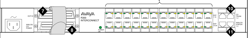

If you buy one , look for my innovative Origami 50wire ribbon cable fit in this case to the front cable pair of connectors.
