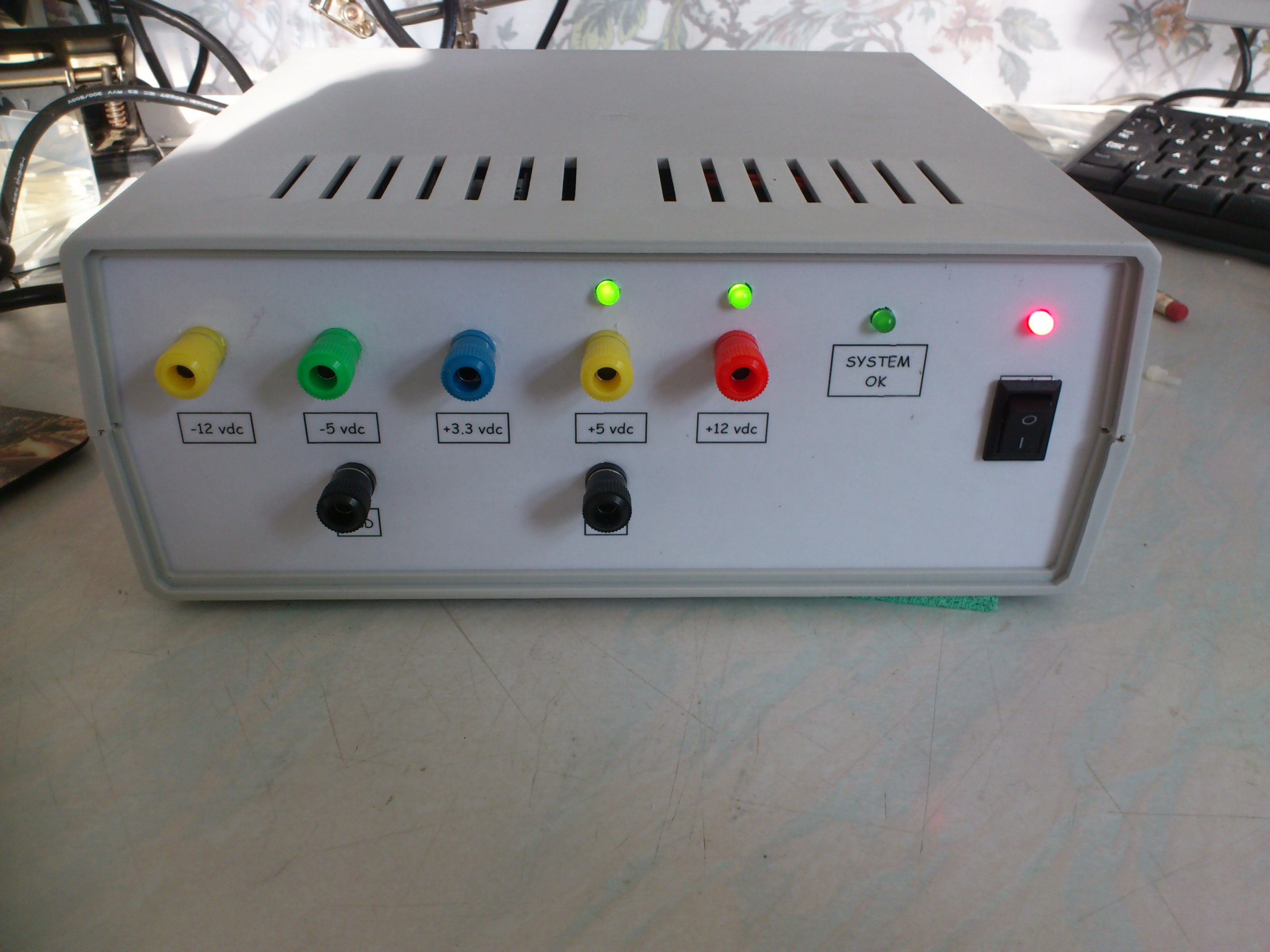

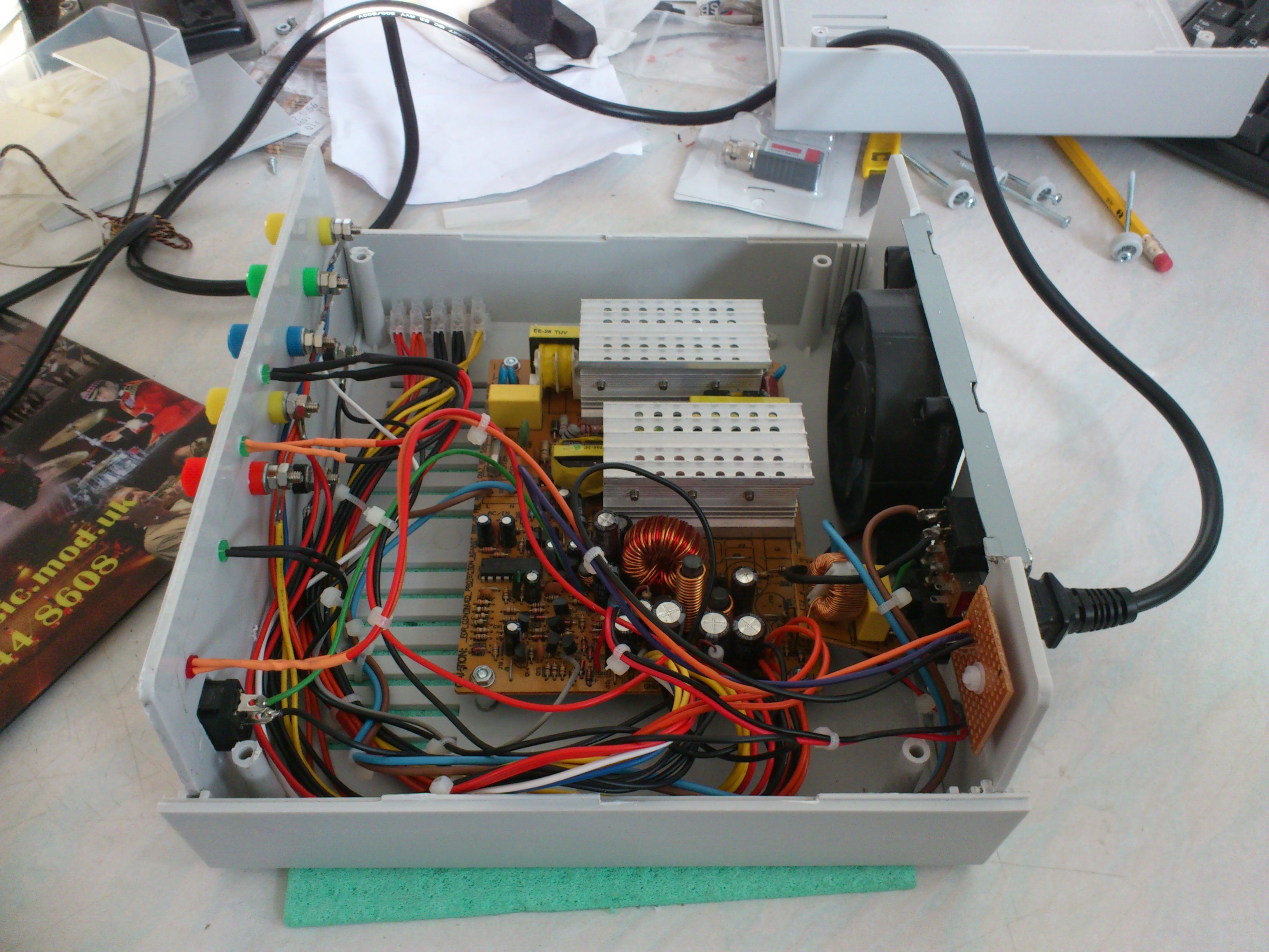

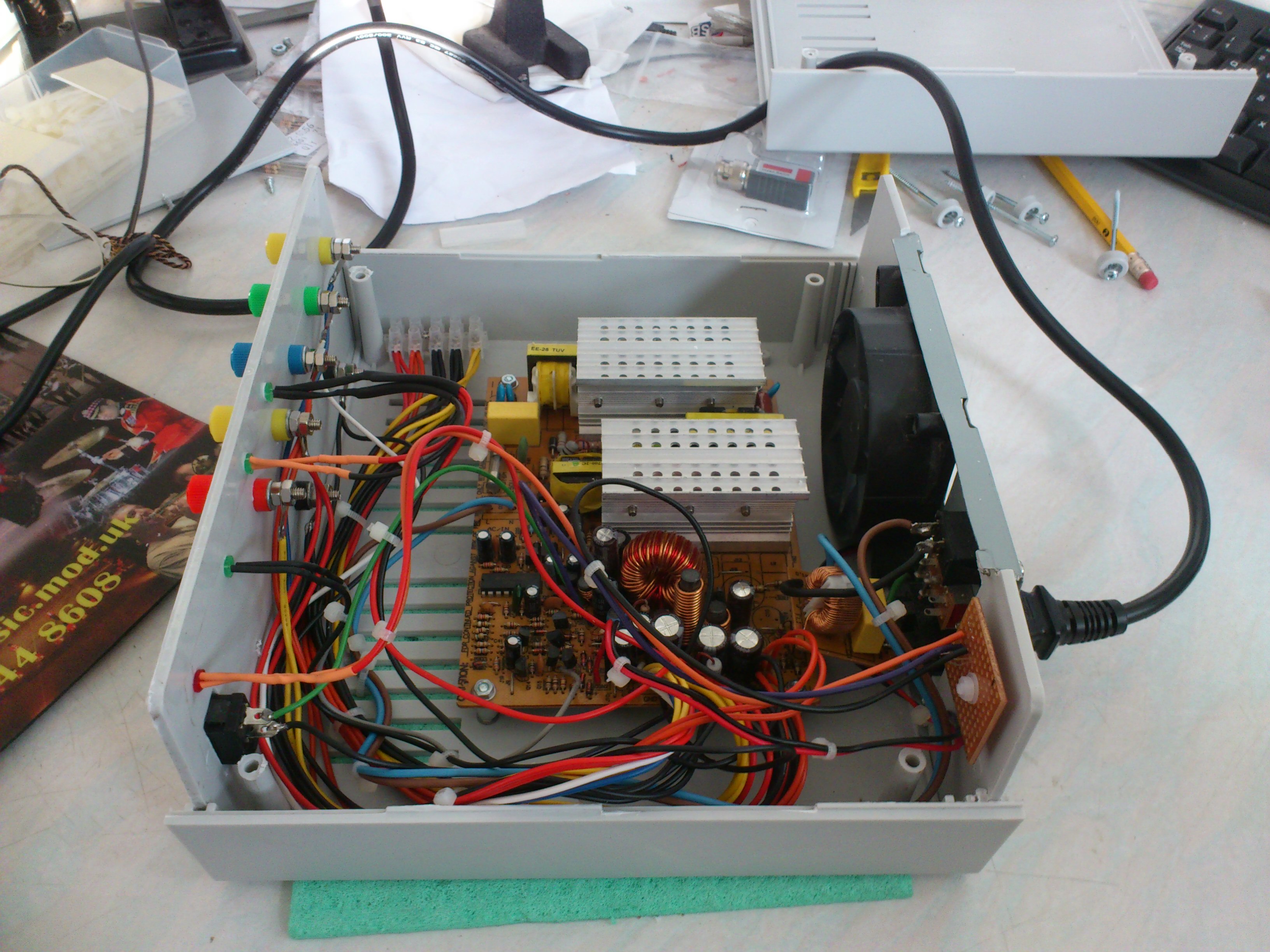

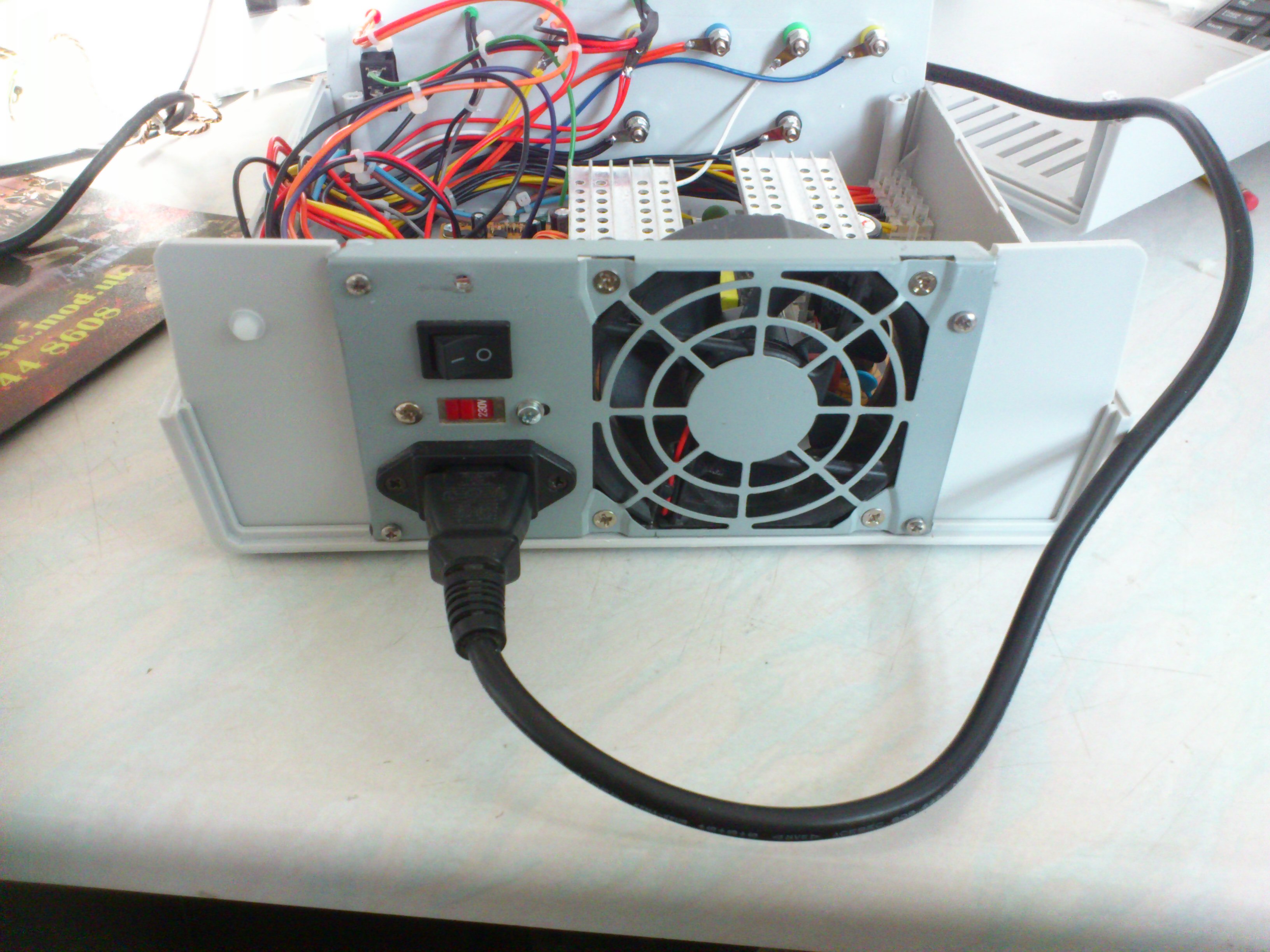

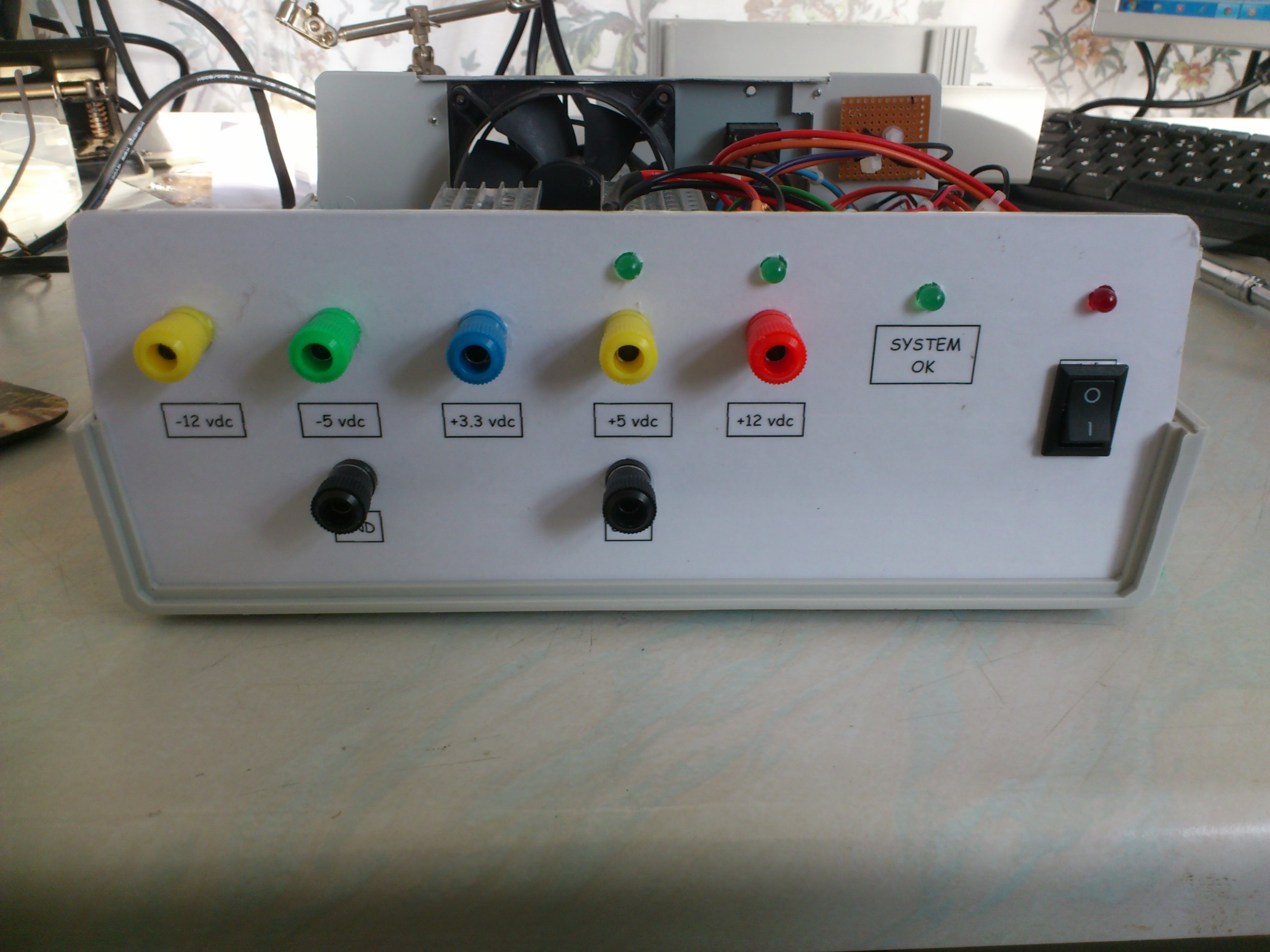

Some of you may know, I've been laid up at home for a while recently and to avoid complete boredom I've been sorting through some junk and having a clear out. Also a while ago, I bought a 0 - 30vdc power supply kit from Banggood but I've only managed to partly build the project as yet. In the sorting process I came across a PSU for a computer, actually a SMPS, brand new in a box and decided it would be useful to convert it for a spare bench power supply because it offers 12, 5 and 3.3 vdc and with decent power, as well as -12 & -5vdc.
The basic conversion was relatively easy, but I did find a challenge in loading the unit without using the customary beefed up resistor trick. I used an LED on each of the positive outputs which is sufficient to keep the unit on and provides some pretty lights for those dark evenings by the solder station. The final challenge involved an indicator to tell me when the switch mode was active/inactive. There is a circuit in the box which provides this info for a computer but it is only signal so insufficient to power and LED. I used my new found novice learning, taught by you guys and put the signal wire to the base of a BC548; voltage and resistor to the LED anode; Gnd to the Emitter and Collector to the LED cathode.. .. .. I was a little surprised that it worked !
There are some pics below for you to have a good laugh at ..
Thanks guys
S

Hi Alec
No, no resistor .. .. the spec I found suggests current on this line is limited to 10mA so I didn't think it necessary. However, if I need to add resistor I'd need to think about how to size it correctly. Thank you, I will check again.
S
Probably overdriving the LED. Does it feel warm in the negative lead?
Normally BC546 only saturates output switch low, when input current is at least 5% of output current and does not need more than 10%.
So if on same 5V supply it might be 20x input current or more. 3V drop from 5V @20mA is 3V/0.02A= 150 ohms from collector or 5V in series.
1.5k for base. If not handy value use 220 Ohm and 2.2k

Thanks for that information, clearly I should have looked into the transistor spec much more than I did. To be honest, it is a component I had left from some timers I built to a kit design, I did think to check the current from the signal line but not the effect on the transistor. The calculation method is useful to keep noted also. I'll get it sorted in the morning.
The wire in the box is without exception the wire used with the original nylon connectors for motherboard etc; all I've really done is to put the unit into a more practical enclosure and add some banana terminals and pretty lights. I'm very much a novice enjoying a new hobby with the help of you guys and the 'buzz' of surprise I get when I power up for the first time and it works is priceless ( I must admit, I did plug this into an extension lead in the garden, and switch on from the house for the initial trial :) ) I can quite readily see that there will be some issues around things working loose in time but once I'm certain of the operation I can deal with those quite easily.
Thanks again
S

The power good line on mine powers a led no problem.
I also have made one adjustable, but its not easy, later chips have under/over voltage protection, you have to fool this before you mess with the feedback to adjust the voltage.
If you manage to find a real old one that has a tl494 you can easily make a adjustable voltage and current supply.

Ah, no not so.. .. the unit has a mains power switch on the rear, but the switch on the front operates the switch mode only. The LED above the switch illuminates to indicate mains power in the circuit, that is the switch on the back is on.
