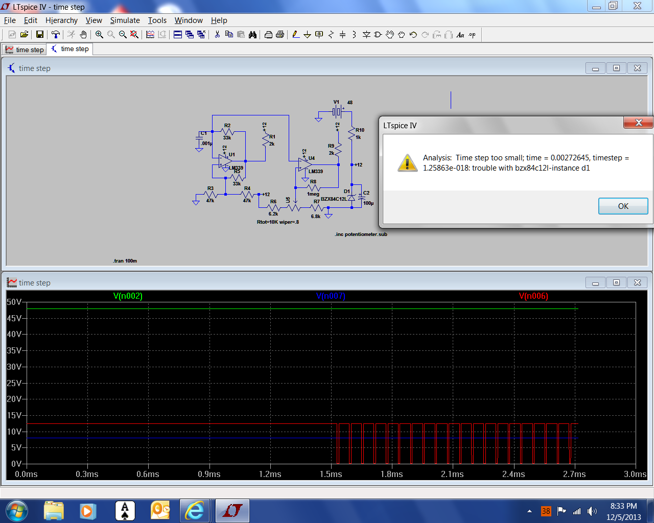

I'm trying to model a simple PWM and get this error.
I've seen it before with zeners. The thing that is interesting is that with the pot set at .5 it runs (10K pot), but at .8 or so it fails.
Any ideas??

I ran you simulation and got the "step size too small" error once, but then I couldn't get it to repeat. Apparently just one of those quirks of the model/simulator.

One thing I noticed is that R8 is "1meg". change it to "1MEG". There is also an unconnected dangling wire off to the right of schematic.
I made the changse but still received time step error..
Ran for me using ver 4.19v, with default sim settings. Sometimes the "alternate solver" works...

This LTspice directive seems to fix it. Add it as a directive to the schematic and the analysis will converge.
Use the Normal resolver.
.options gmin=1e-10
What it does:
Add a small conductance of 1e10(=10GOhm) parallel to every diode of transistors and diodes.

Ahhh. I fell better all over. :joyful: It fixed that circuit and the more complicated one. I read something about this but didn't know how to do anything about it. I'll write it down with my pass words so I don't loose it! :D Thanks!
