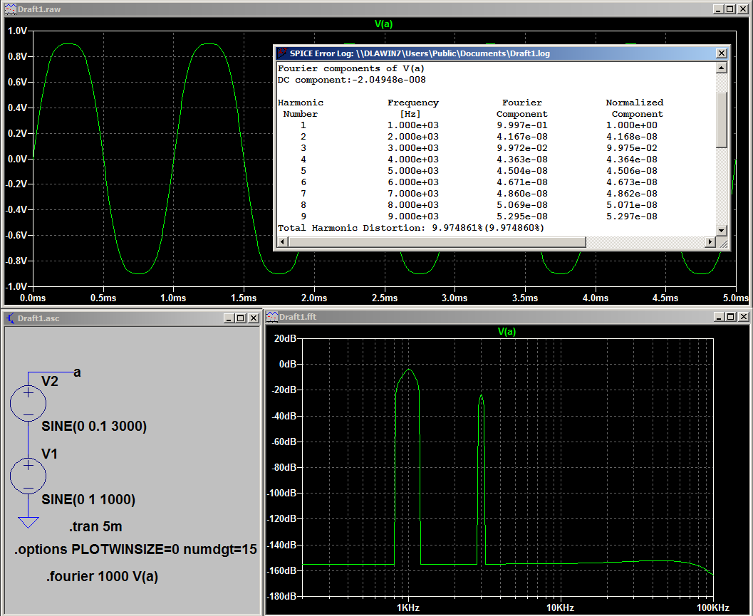

Read the "Waveform Arithmetic" topic in the help file. Note the discussion about .OPTIONS plotwinsize=0 numdgt=15. Add that to the schematic. Plot about five cycles of the waveform.
In the upper plot window, VIEW/FFT generates the FFT plot, which shows that the third harmonic is down 20db from the fundamental, which is what the two sources add to...

the spice directive should be put on the schematic. if you are using a 1khz tone to test your device, and your output node is marked "out", the correct way to type the spice directive is:
.fourier 1000 V(out)
after running the sim, open the spice error log, and you will get the overall thd, plus a list of the magnitudes of the harmonics

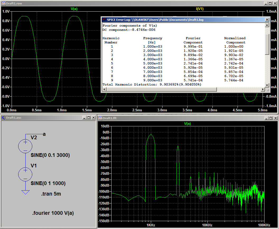

Without the .options statement. The .fourier statement has to refer to a node that actually exists in your schematic.
This is with the .options statement. Notice how much cleaner the FFT is, and that is reflected in the error Log.
