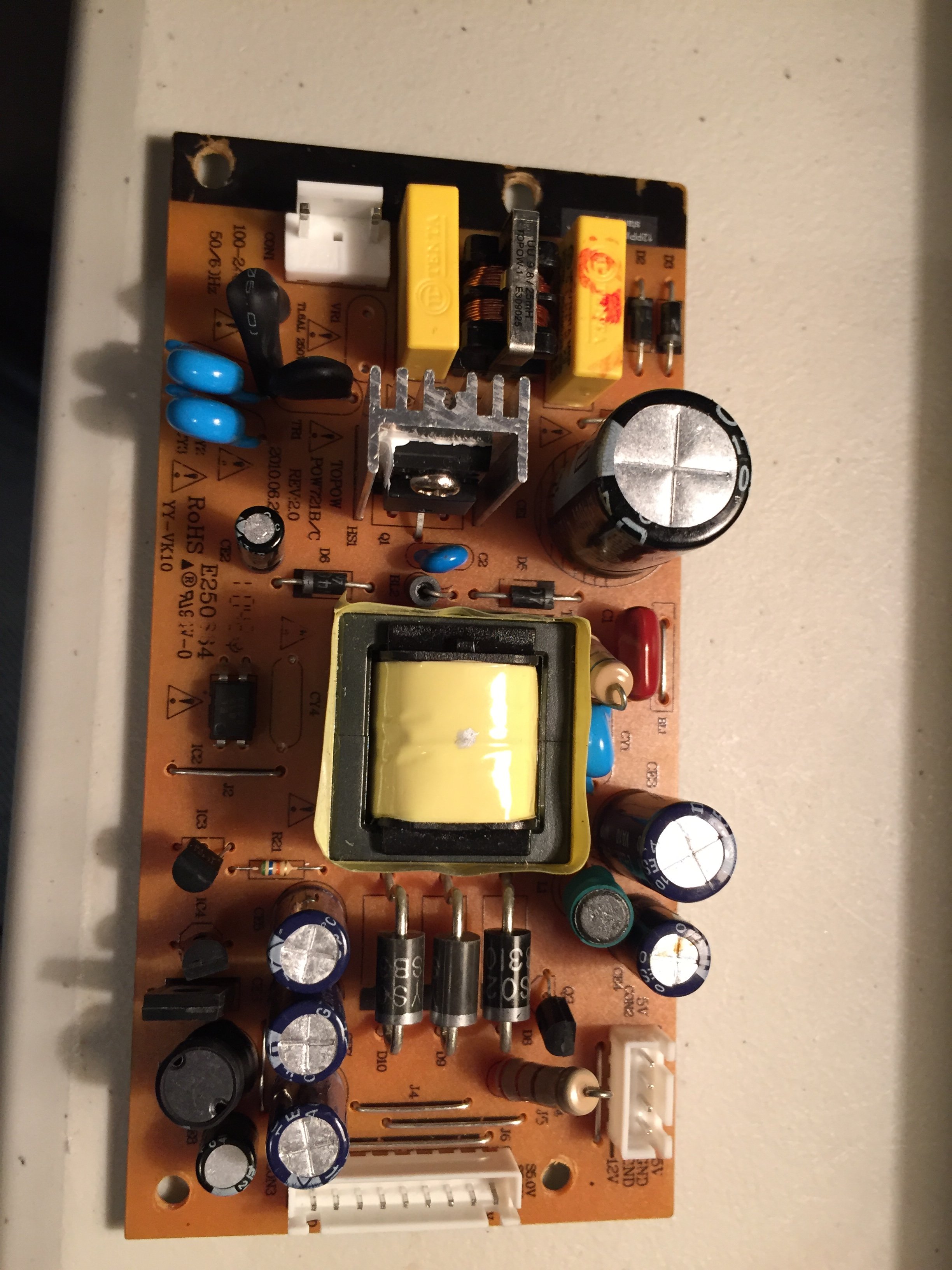

can I test MOV'S with my multi meter? I have a blu ray player power board that had a spike and trying to figure out what is at fault. Suggested by DerStrom8 to test the MOV'S but I tried in diode mode, nothing and resistance got nothing? Here is a pic of the board and I checked all the caps and the diodes too. I see 4 blue MOV'S and have desoldered one end on those. I'm getting back into electronics after a long hiatus so I've been doing a lot of reading and refreshing what little I used to know

The 4 blue MOV's in your diagram look like capacitors Y type.
What are the numbers printed on their sides.
Appears to be a black thingy near the fuse. Either a thermistor or Mov.

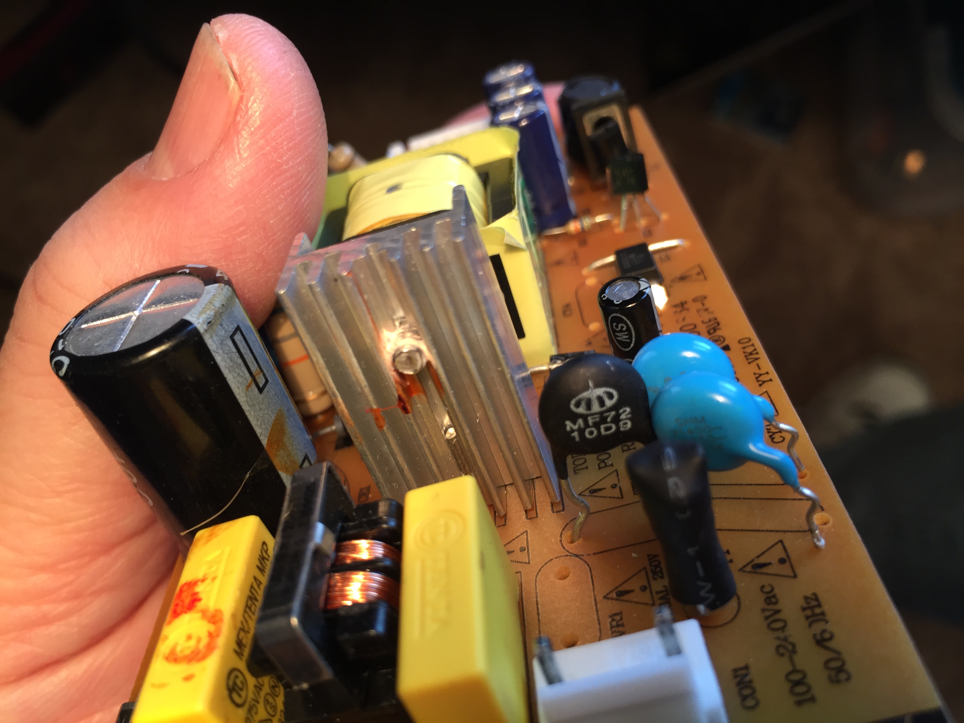

The black part next to the fuse looks like a thermistor MF72 10D9 and and I went ahead and pulled it and measuring with my meter set on ohms it acts as a dead short, actually it is about 10k ohms so maybe it's OK? The blue ones by the fuse are SHM - X1400 Y1250 B471K F and I get a pF reading 46.5 set on the 2000pF range.

What is the voltage across the main reservoir capacitor ? (And what is you mains voltage as you give no information of your location.) Take great care measuring this as it will be a lethal voltage. Also this capacitor will remain charged for some time after the power is removed.

I measured it when I first opened this up, I get 120v AC most of the way but after the big diodes I get nothing so it's like there is no DC voltage. I need to solder back some leads and I'll check it all again.
Are you saying that you get 120 volts AC on the input of the bridge rectifier but nothing on the output ? As you say that the fuse did not blow then this is unususl as diode normaly fail short circuit which should have taken out the fuse. There should be about 165 volts DC across the resovoir capacitor which is normally connected directly to the output of the bridge rectifier. Can you trace out the schematic for the circuit on the input side of the transformer and put it in your next post ? I can only see two of the four diodes that would form the bridge rectifier.

Your blue ones are caps, 471K would be 470 pF.
MF72-10d9 is a NTC thermistor where the 10 is its resistance valve at room temp 25C, and D9 is the diameter of the devices element. MF72 is it's power rating. ie how much current it can handle without destruction.
It's a NTC, meaning resistance goes negative/decreases when heated.
Dead short means very low resistance(less than 1 ohm), however, you also stated 10k which means 10,000.
Please clarify. Hook up ohmeter, read value, should be 10 ohms, use solder iron tip close by to warm device for a second or so, valve should decrease.
Or even the heat from your fingers would warm it up to lower the value

The veristor is indeed 10 ohms and as it gets warmer it goes down. The blue caps measure a little low BUT my capacitance meter is pretty cheesy and the caps are exactly the same when measured so I think they are fine.

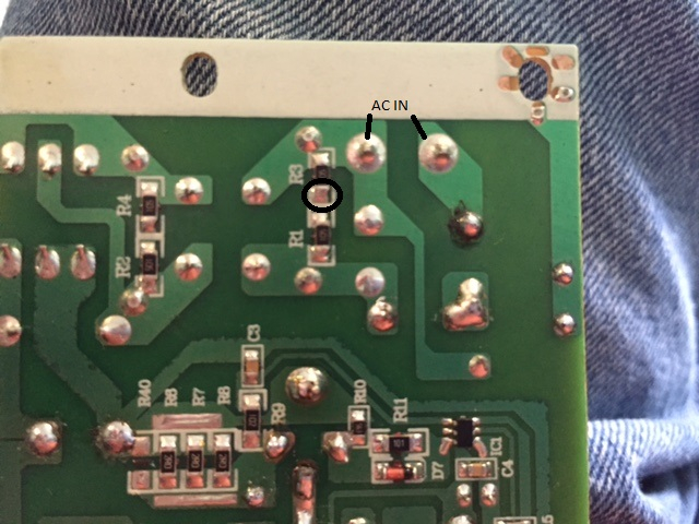

I decided to resolder all the components I tested and start over. I started right at the AC in and then to the very next spot and so on, I have nothing at a surface mount resister labeled 105? Here is a pic link https://imgur.com/NUHl583

You are not giving clear information. I am guessing that when you say "resistor labelled 105" you are referring to resistor R3 (Your picture is not clear enough to read the values on the resistors so I am guessing that the resistors (R1,R2,R3,R4) are labelled 105 which is the value (100K)) You also say you have nothing at this resistor but you also need to say which end of the resistor and what point it is with reference to. These resistors play no part in the functioning of the power supply. They are only to discharge the two filter capacitors so that you do not get a shock if you touch the pins on the mains plug from the charge stored in the filter capacitors.
This is how I would trace the AC trough to the rectifier. This description is from the etch side of the board. Hold the black probe on the left hand AC in pin and the red probe on the right AC in pin You should read the mains voltage (I will assume it is 120 volts.) Move the red probe to the square pad below the right AC input. The reading should be 120 volts. Move the red probe to the pad to the left that connects to the bottom of R1. The reading should still be 120 volts. Move the black probe to the top of R4 and the red probe to the bottom of R2. The reading should be 120 volts. To go further you need to say if my guess about the board layout from the component side is right or wrong. My guess is that there is a third diode to the left of the two diodes visible at the top right of the picture and there is a fourth diode at right angles to these three diodes next to the large capacitor. Also what is the part number of the 6 pin chip IC1 ?

Yes that is what I did, I kept the black lead on the AC line in and moved the red lead to that surface mount resistor but when I get to the other side of that resistor there is 0 volts and if there should be 120 volts on the other side of those resistors then I need to get a couple of those to try and see if that fixes it. Next question is can't I test with a regular 105 ohm resistor in place of the blown surface mount resistors just as a test?
Never mind, I see now that I had the wrong side of the AC line in, I'm getting voltage there. Actually I'm getting 120vAC all the way to the large yellow transformer, so maybe I need to look at the other side of that for DC voltage? sorry for the confusion so I'm going to continue on and let me get some solid data on what's what and if I find something I'll post it. Thanks for the help

I made a mistake last night (Post #15) The 105 marking on the resistors indicates 1M (Not 100K as a said last night.) I realised when I was thinking if I should have explained how to read the resistor code and convert it to a resistance value. The first two digits are a number. the third digit is the power of 10 that you multiply this number by to get the value. So 105 means 10 x 10^5 = 10 x 100000 = 1000000 One million ohms (1M) I think you should get someone with electrical knowledge to look at it as you seem to have no idea how a switch mode power supply works and you will not answer questions. The 120 volt AC mains is first rectified to about 165 volts DC on the large capacitor. The DC is then chopped by the mosfet which is driven by a switch mode regulator IC to give a high frequency (A few hundred Khz) square wave with a variable mark space ratio. this is then stepped down by the transformer and the transformer output is rectified to give the low voltage output. The output voltage is monitored and fed back to the switch mode regulator chip via an opto coupler to to control the mark space ratio of the square wave. I think you should try to learn electronics by playing with simple low voltage circuits first before attempting to fix switch mode power supplies.
