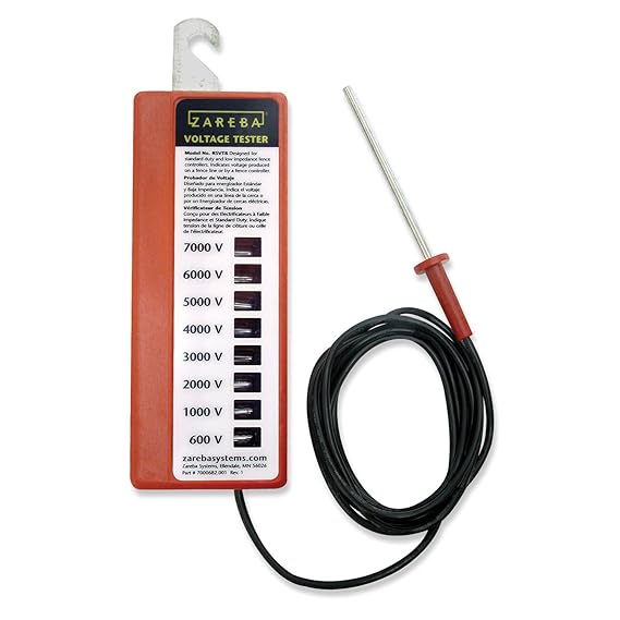

Does anyone know how you should test an electric fence unit ... under a realistic load ... short of asking the kids to "touch this wire" !
Farmer tells me that it has the built in ability to throttle back the power if there's an overload ... to the point of shutting down if too severe.
He says that it is doing that now ... even with very little fence attached.
I did find a Gallagher load tester advertised, that has a 100 ohm and a 500 ohm load ... but no extra info to explain what I should be seeing.
The unit in question is a Thunderbird MB1750R and supposedly good for 135km of fence!
Output 13.72J at 142 ohms resistive load.

You could look at the fencer output with a high voltage probe and an oscilloscope (you could make a ≈100:1 probe by soldering ten 10megΩ, 1/2W resistors in series connected to a 1 megΩ oscilloscope input. Put the resistors in a plastic sleeve for insulation.) .
It likely outputs several thousand volts when operating normally.
If the scope is set to "AC" the divider will not work right and burn out the scope's front end. Don't rely on the scope's 1meg resistor. You should put a resistor at the bottom of the divider.
I have seen circuits with three 10meg 1 watt resistor in a string and a neon bulb at the bottom.

Thanks for that. Never even though of it but I do have a couple HV probes from back in my tv fixing days. I still need to add a load to see what happens ... but should make it safer to monitor.
Thanks Ron. I got caught once using my scope on a mig welder (many years ago) ... fried one probe. At least I can use my HV probe ... I just need to work out a suitable load.
