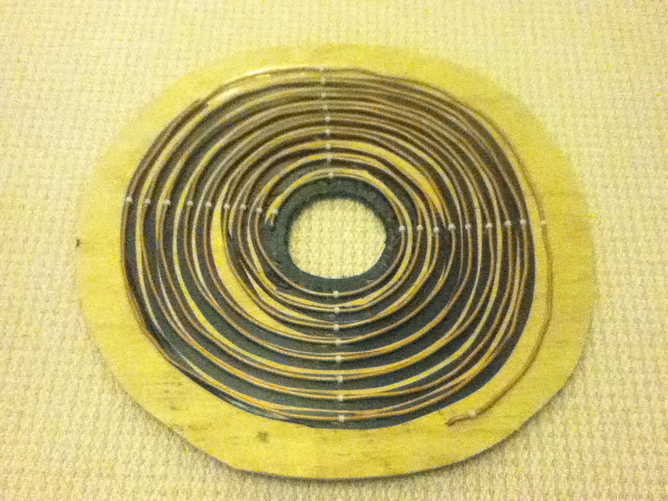

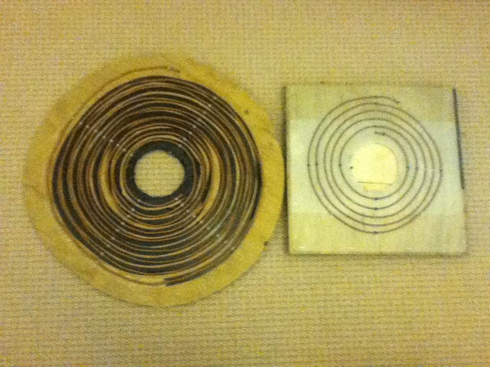

So I've done some tuning and I think what I'll do is build a bigger primary coil!
Marco
Hey Matt
I've built my primary coil and here it is:
Here is one with the original coil for scale:
I hooked it up a couple days ago and tried it out, with a metal pole a couple centimeters from the secondary coil top and no sparks were coming off at all so now I'm really confused.
Help / Advice is appreciated
Thanks,
Marco
Hey Marco, good to hear from you!
As with before, you can't just hook up a primary coil and expect it to work perfectly. Nothing has changed--you still need to tune it.
Since you were getting fairly close towards the end of the first primary, I imagine it would be fairly close to that same point on the second primary. Tuning is the key to making it work at all, and patience helps with that. Go ahead and try moving the secondary connection around and see what happens.
