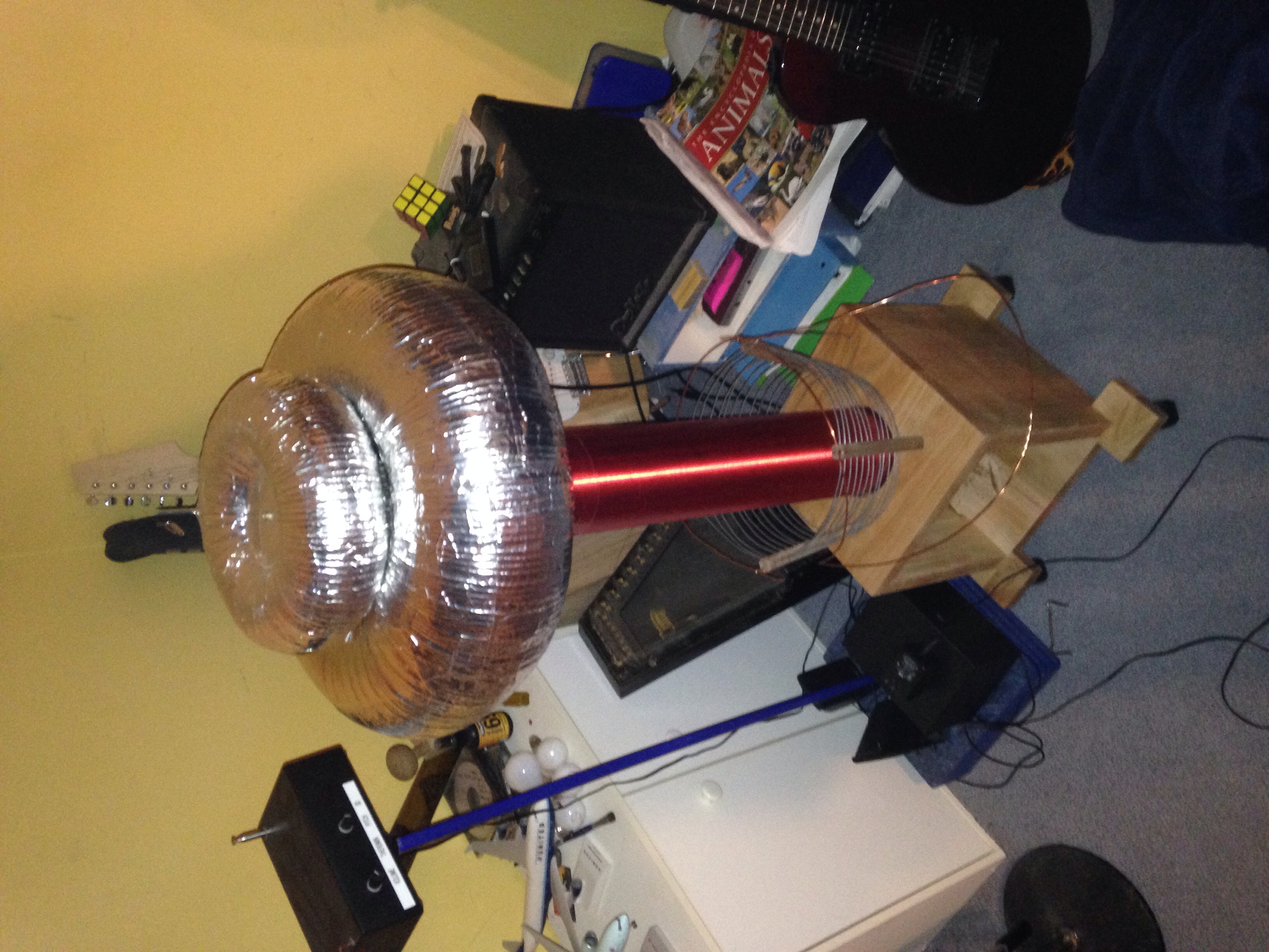

    I didn't have any copper tubing for my tesla coil, so I used steel wire , about 12 gauge. Will that work? It made some small arcs from from a tabletop coil driver (no the driver did not burn out) when I quickly tested it. The arcs were only around an inch, but would it work if I had a power supply that would actually be used to power something this size, and not a small coil? For example, flyback or NST? I wasn't sure if steel would work.

    Photo by the way. It's about three feet tall. Without the topload. image.jpg

    Hi Yergaderga. Looks great so far!
    Steel wire should be ok, though if you can get your hands on copper tubing/wire that would be even better. Using steel wire may hinder the flux fields around the coil from transferring the energy into the secondary. But you should be fine for now.
    As for getting small arcs there are several reasons. First of all, for a Tesla coil that size I would recommend a 450W+ power supply (I'm assuming this is a SGTC). For example, a 15kv 30mA neon sign transformer would be good. Obviously higher current would be desirable. I wouldn't go beyond 20KV though, of course 20KV neon sign transformers are pretty tough to come by ;)
    Another possible cause for small arcs is that the coil is out of tune. If you're using a tank capacitor that is designed for a smaller TC, the resonant frequency of the primary and secondary circuits will probably not match up. Out-of-tune primary and secondary circuits are the most common cause of poor Tesla coil output.

    Yeah, I'll need to work on that, of course. Is there any power supply other than an NST I could use? Also, how safe is an NST relative to other ways of powering it ? (MOTs are definitely not happening!). I'll have to look in junkyards and whatnot. There aren't any neon shops around. I don't know where else to look for them that they would be cheap.

    Besides NSTs, OBITs are another good choice. That is, Oil Burner Ignition Transformers (for oil-fired furnaces). I suppose you could drive your coil with a very powerful ZVS flyback driver/transformer, though that would not be ideal.
    As for MOTs, they are usually not a good idea, as you seem to know already. Yes, they can be wired up in series/parallel with chokes to get a higher voltage, but the insulation will likely break down once you get a useable voltage from it. Most people who use MOTs to drive their TCs immerse the whole transformer setup in oil, which gets very sloppy.
    Keep in mind, if you do end up getting your hands on a neon sign transformer or oil burner ignition transformer (from a junkyard, perhaps), make sure it's one of the older, heavy iron core type, not the solid-state ones. Solid state ones run at a frequency much too high for use with Tesla coils.
