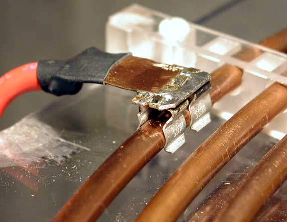

i am building a 1.8KW tesla tower and i have a problem
i couldn't make the primery part round because the wire was too strong,
plus my HV Hawg capacitor is 21.6 nF instead of 21.2 nF ,,
does that effect my design and will it work ?
thanks in advance for your help

Hi TheStyle1. Welcome to AAC!
It's actually very difficult to get the primary to be perfect. Trust me, I've tried :D
I looks like it might be round enough to work, but it won't operate at its full potential. Make sure none of the primary windings are significantly close to each other. It appears in the photo that the second, third, and fourth turns (viewed from the angle the camera is at) are kind of close. I would suggest trying to separate them a bit.
A method you could use to make the primary more round would be to add more supports. It appears you only have three there. If you add one in between each one (for a total of 6) it will help a lot, I'm sure.
Also, this is going a bit off-topic from your question, but it looks like the secondary is a bit short. How long is it? How many turns? From this angle, it looks to only be 12-14 inches, which probably isn't the best match for your primary. And I'm not so sure about the topload, either, but the larger capacitance may balance out the lower inductance of the secondary....
Sorry, I'm just typing out my thoughts as they come. I would highly recommend at least adding a strike rail just above the primary. If this coil works normally, it will strike the primary a lot, sending high voltage, high frequency spikes into the tank circuit. That could be very dangerous, not only for the cap and transformer, but also for you. A grounded strike rail is highly recommended to ground any arcs that stray in that direction.
Keep us posted on your progress. I am always interested to see a Tesla coil build! And as always, please be careful ;)

for the time being i just want to see the sparks as its my first project and i had an idea that will separate them a bit i will use a piece of wood for that.
regarding my seconday, thanks for askin again, its 22.5 inch long around 1100 turn ,
i just designed the table to make it movable so that i can change the inductance and make sure that i will be able to make changes during the test,
another issue i have, is that i don't know how to connect the seconday to ground,in our power system we have to ground wire, should i connect it to a rod and bury it in the gound? how deep? and the spark gap is 3 or 4 inchs will do

you will certainly admit if I say your primary winding looks pretty messed up other than the secondery coil.
I suppose you used copper pipe of 6mm outer diamater for the coil.
If the material is too hard to bend you might heat the entire coil in a camp fire until the copper turns red hot.
Take it out of the fire and allow cooling at ambient temperature. After that treatment the copper gets as soft as butter.
Stretch out the entire coil evenly on the ground to polish the surface (for a better appeareance, using steel wool) and start winding inside out using 6 clamps to hold the pipe. Use clamps to hold the work you've done so far. The windings should have equi-distance horizontally and vertically.
(I saw several possible dead shorts in your coil.)
I have wound copper pipes around huge fans of 2.85m diameter to measure air speed. The finished circle was perfect and so you should look your coil.

Ah, thank you for posting the other picture! The secondary looks about right there :D I guess the angle just wasn't the best in the first one.
Anyway, to start with, a 3 or 4 inch spark gap is much to large for the TC, unless you have a 150kV neon sign transformer. It should be more like half an inch, though you'll need to adjust it for best performance.
NEVER ground your secondary to your household ground. It should be completely independent from the rest of the circuits. Take the wire at the bottom of the secondary and attach some insulated wire to it. connect the insulation to a 3-4 foot rod and pound it 2-3 feet into the ground. Generally, the deeper the better. This ties the "negative" side of your secondary winding to earth, and will allow the secondary and the topload to create an LC circuit that will oscillate at a certain frequency. This is the frequency you'll want to match with your primary tank circuit.
Instead of wire, try copper tubing. At these voltages and frequencies, the wire has a "skin" effect where most of the current travels on the surface anyway. For making perfect-looking round bobbinless coils, I wind them around a cylinder that's smaller than what I want, then they "spring back" to the larger diameter. With this you would probably want to find a cone shape to wind them around.
Won't affect it, this design is a relaxation oscillator that will find its natural resonance.
It often helps to make the tunable primary, though. Wind an extra turn on it, and instead of having that outside lead head back to the supply, use a small battery clamp or something like this -
- so that you can adjust it for peak resonance with the secondary.
Agreed, on both accounts. Tubing is probably the most popular among tesla coils enthusiasts nowadays. As for the capacitor, a larger capacitance simply means you'll need less inductance in the primary. That is where the tuneable primary comes in handy--you can simply clip the cable on to any part of the primary to "tap" it and produce the correct resonant frequency. You may even want to consider building a Tesla Coil tuner, as found on this site. It will help you tune the tesla coil primary so that it resonates properly with the secondary. It is a very useful tool that will help you a lot.
