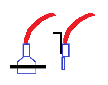

To illustrate, think about a wire the solders into a hole in a regular single sided PC board. You can push the strands through, solder it onto the copper clad, enough solder and you're all set. But the problem is that the now solid solder does not allow the wire at the very joint to flex, so it gets stressed too much and eventually breaks.
Now think about this....instead of drilling just one hole in the PC board drill three holes. One hole goes where the copper is, which is the 'normal' hole, the other two go right in line next to the first hole, so they are all drilled more or less along a line. The second and third holes are drilled slightly larger diameter, to accommodate the insulated part of the wire, and the first hole is just enough to take the strands. Then thread the wire through the 3rd hole, then up through the 2nd hole, then finally through the 1st hole with the copper, then solder it as usual.
The result is that when we pull on the wire now, the first two holes and the insulation take the most stress, and that relieves the stress on the joint itself immensely. Something like this could last a long time whereas the one hole scheme could break very soon with a little flexing.
Now apply that same idea to a terminal, which also has a wire attached, and you get the idea. Relieve the stress on the joint itself and it lasts a lot longer.

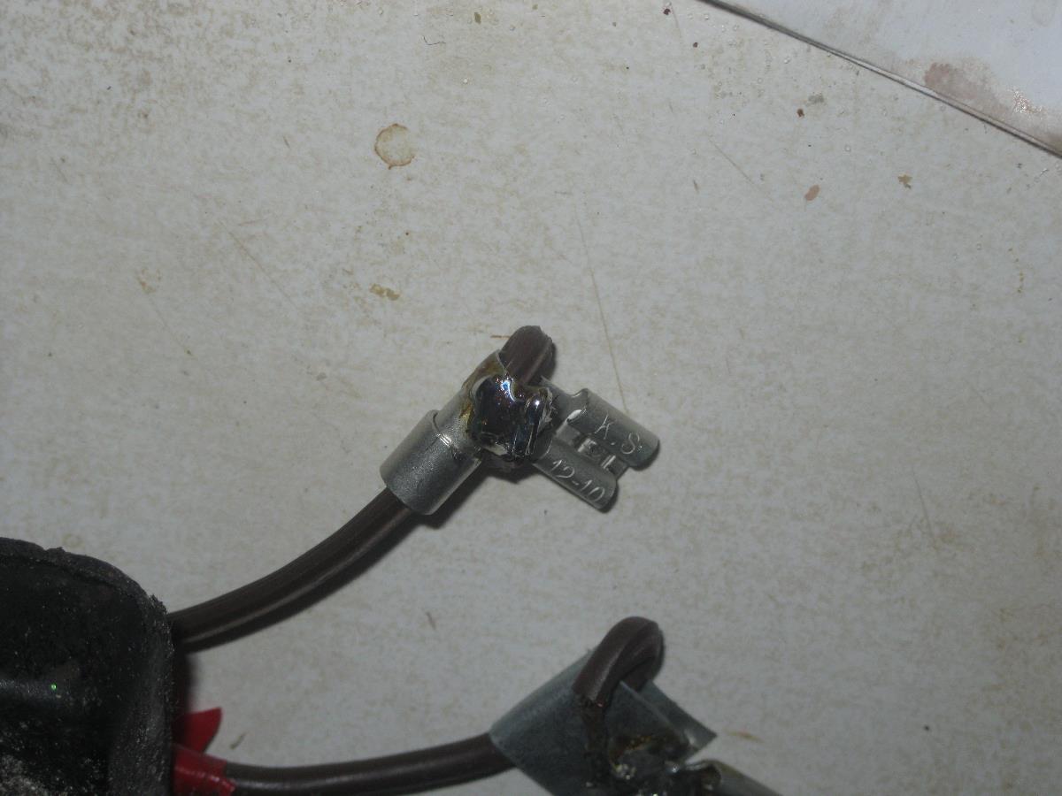

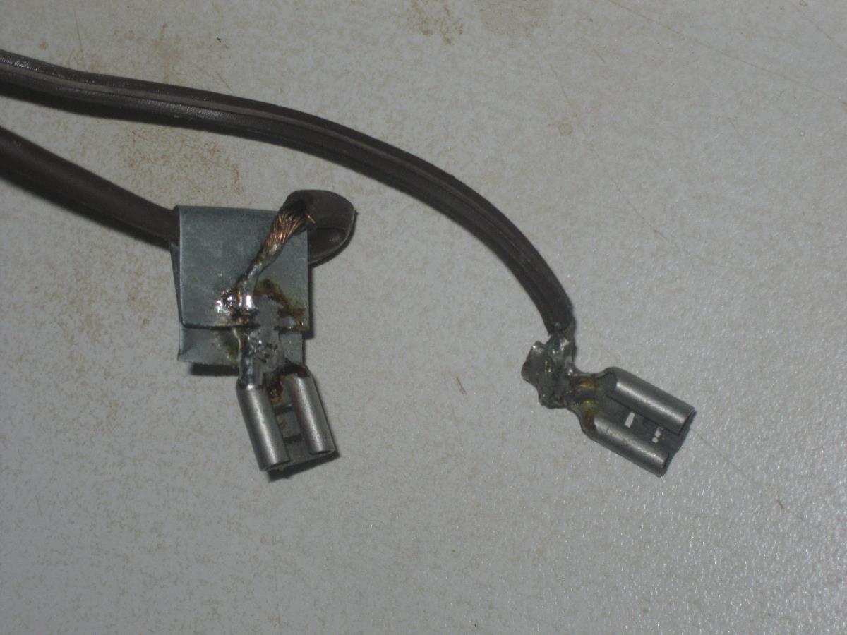

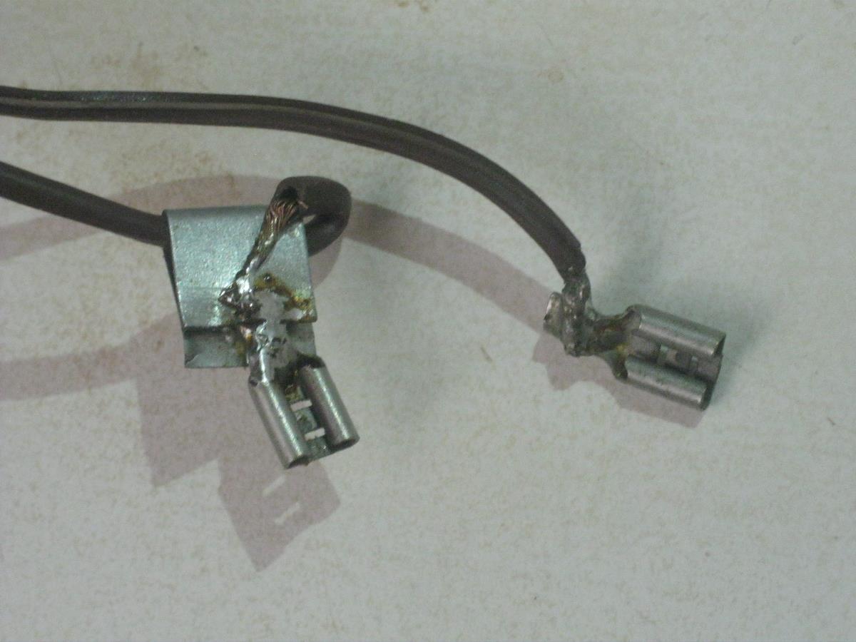

Here are two pics of the terminals showing Fix1 and Fix2. Fix1 (right, both pics) was done by just soldering the wire at a 90 degree angle after wrapping the copper strands around the barrel of the terminal. Fix2 (left, both pics) was to use a small piece of steel, soldering that to the terminal first and then running the wire (with insulation) through the large eyelet, then soldering the end to the terminal or near the terminal.
Even with Fix1 the setup lasted much longer than with a normal crimp or double crimp type, and i expect Fix2 would last a very long time because that's got a nice grip to it, large enough for thumb and forefinger. It's ugly though as you can see, although i could have done a better job if i wasnt in a hurry that day.

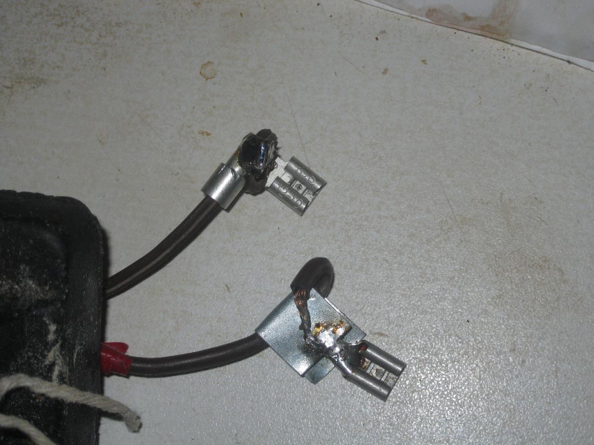

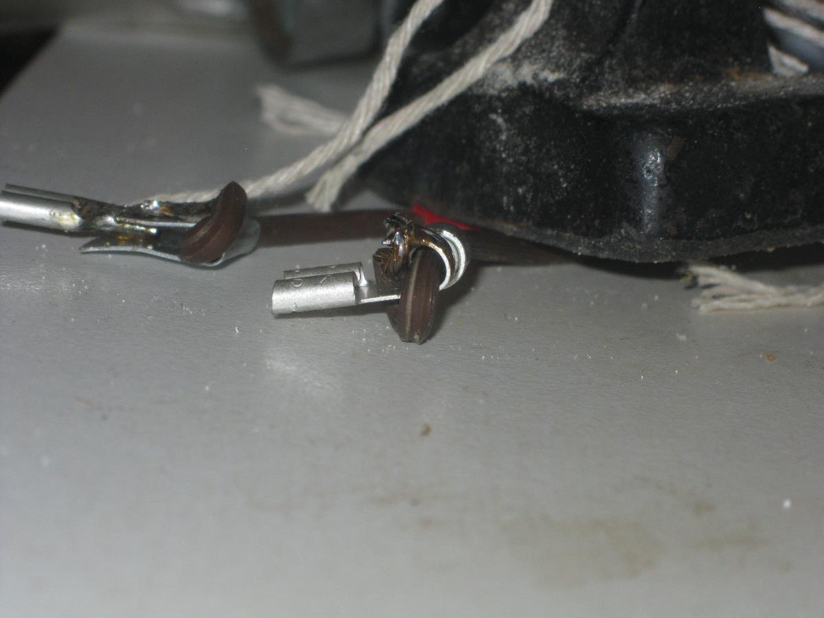

Here are a couple more pics more to the point of what i am after. Other ideas are also welcome of course, especially ones that involve high durability.
The one with the big metal tab soldered to it is the second type of fix, the one with the more normal looking side entry is the newest (third) type of fix, where the wire enters into the sleeve that normally gets crimped onto the insulation or wire, and then wraps around the body of the Faston by going behind it first (still with all insulation) and then coming around to the front, then the stripped end gets soldered to a little tab that was bent up from the original unmodified connector where that tab originally formed part of the sleeve. Id didnt know i could bend that up until i took the plastic off of the Faston (this one was completely covered in plastic insulation).
The third pic here shows the two connectors from the edge so you can see how the wire wraps around the metal before the end is soldered. This provides much higher durability.
If they made connectors like this they could do a much better machining job.

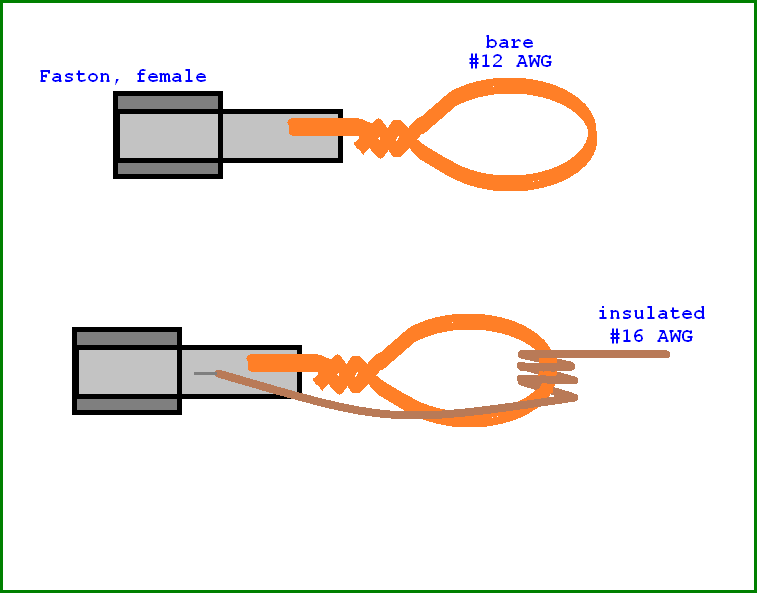

Another thought was to use heavy gauge copper wire, like 14 or 12 gauge wire, to form a loop with maybe twisted ends, one lead longer though sticking out of the twisted end. The long lead gets soldered into the Faston, the wire from the device (with insulation) gets wrapped around the loop once or twice, then the stripped end soldered to the Faston on the top of the sleeve (not a right angle Faston) . Now when the wire is pulled the loop gets pulled by the wire with the insulation on it wrapped around the loop wire, and the loop pulls on the Faston but in line with the line of pull when it is normally pulled off, so all of the wire stress gets distributed around the loop where it bends.
I'll draw a quick pic up.
I can not see your link for some reason, is it working ok? I'd like to see what you are talking about there as that sounds interesting too. Keep in mind however that this is not just about pulling on the wire by accident to remove the Faston, it's also about durability even when not trying to remove the Faston, when the wire has to move around a little with the human operator while the battery stays flat on a work bench or table. I have enough wire length so it's not too bad, but it will still have to move around a little.
In the drawing, the 12 gauge wire is soldered to the Faston first, then later the 16 gauge device wire is wrapped around that and then soldered to the body of the Faston. There is a little slack left in the wire so the part that is wrapped around the 12 gauge wire takes all the stress.

I had a similar idea to that in your TerminalDrawing-1.gif. It was to braze or epoxy on handles to the female Faston connector, as ullustrated in the attached image. Two alternatives are shown. The LHS image has a cross-member fixed to the flat side of the female slot;), of a stiff material, say steel. You use your fingers on the handles to push the connector down & to pull it up. The RHS image has a plate with a flange, with an inverted L cross-section stuck to the female connector. You grip the flange to push down or lift up. In both cases there is no strain on the wire and so it should last indefinitely.

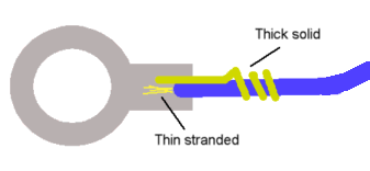

I use a similar method to MrAl's. A thick wire is soldered to the connector and its free end wraps around the flexi-wire sleeve:
