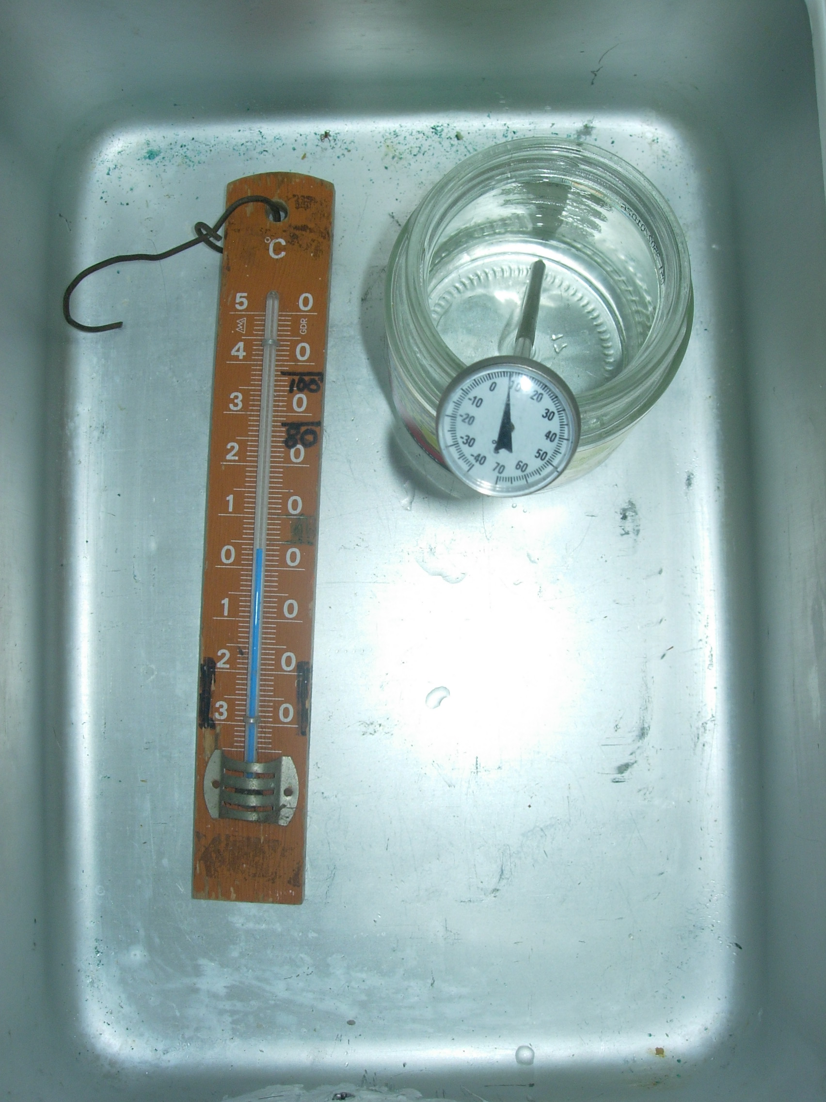

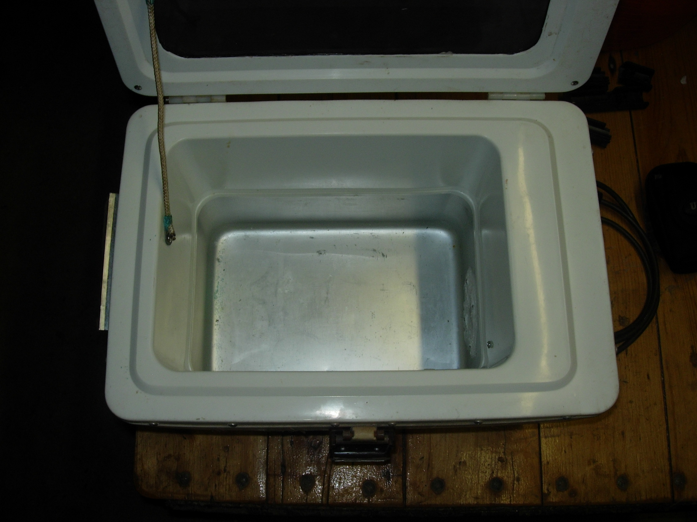

With Peltier type fridges the thermostat in the picture you posted will be an over temp sensor for heating. Heres a picture of a typical peltier fridge, theres no need for a thermostat for cooling, as they are only capable of about zero degrees C cooling in practice. As the external temperatures rise above 25deg C, so does the internal temperature. They are just barely a cooler, but they work very well as a heater if you reverse the polarity to the peltier device, that's why theres a temp sensor. Last pic is after 8Hrs with an ambient temp of 25degC. The internal thermal sensor on this fridge is 90degC for heating mode, which I have disabled as I didnt want it for heating.
