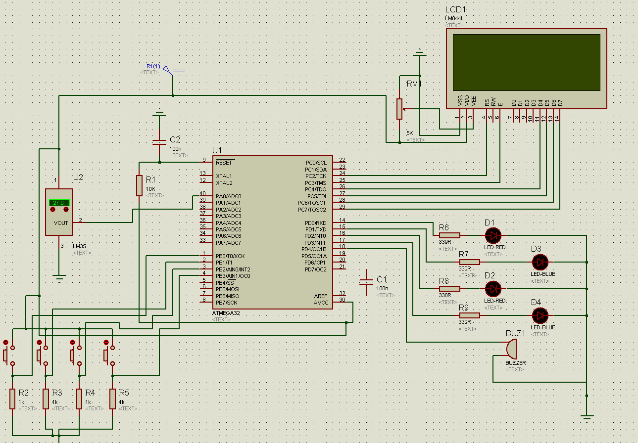

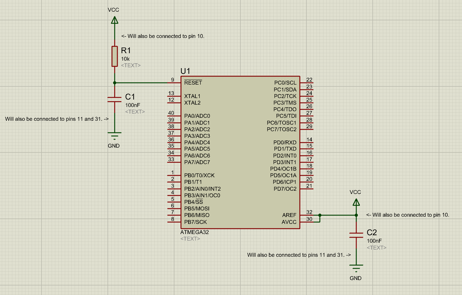

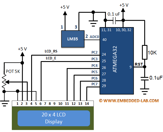

Pins 11 and 31 are connected to net "GND" and pin 10 is connected to net "VCC" by default. If you name Power Terminal "VCC" it will be connected to pin 10, and if you name Ground Terminal "GND" it will be connected to pins 11 and 31. Take a look at the schematics you posted (the blue schematics).. you'll see that pin 10 is connected to VCC and pins 11 and 31 are connected to ground.
