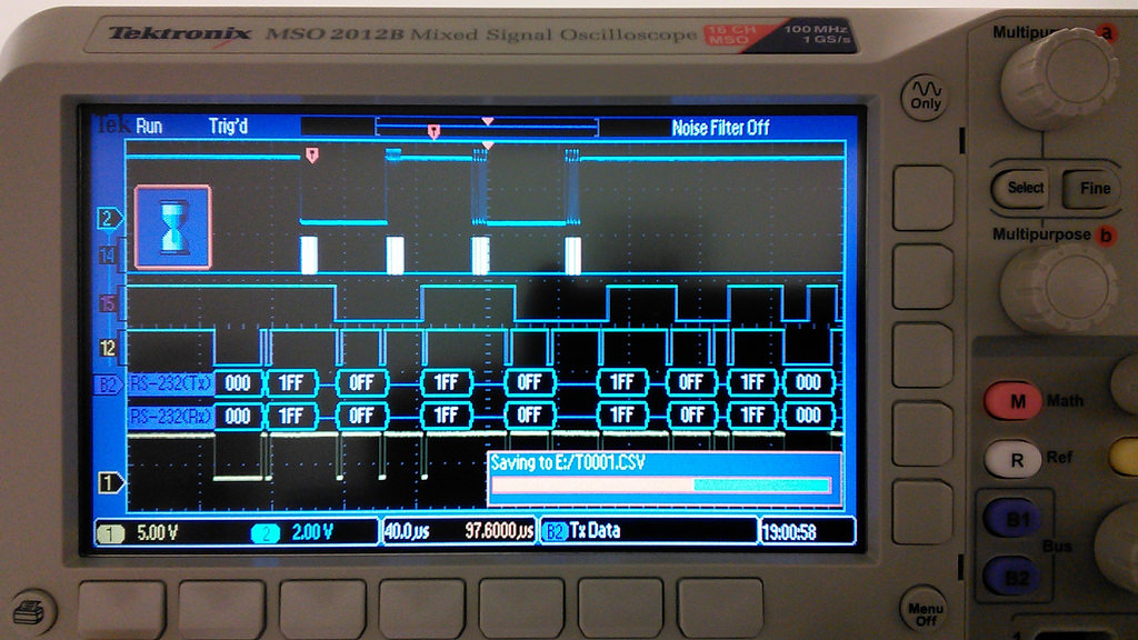

A screen shot of the scope in action on the PIC18F45K80 generating software test signals. Worth every nickel.
Top to bottom:
SPI: to lcd display module
MOSO analog probe signal
SCK digital
RS232: to light-link transceivers
RX2 interrupt toggle digital
RX2 data digital
TX2 data decode, scope trigger on hex data 000,1FF
RX2 data decode (light-link loopback)
TX2 analog probe signal
Load the RS232 and SPI data buffers then start the interrupt driven data transfers.
