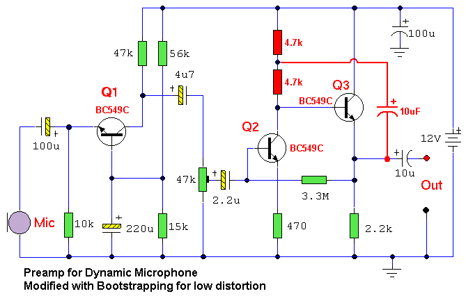

So, as I want to use a fair mic preamplifier, what is your idea about the below dynamic mic preamplifier?
That preamp shows BC547 ordinary transistors that have a very wide range of spec's. I would use BC549B transistors that are low noise and are selected with "B" spec's.
The distortion wasn't measured. I would add a bootstrap capacitor and resistor to it to reduce distortion.

I wouldn't have thought bootstraping would make much difference?, you're not looking for massively high output levels from it, and it's already a pretty reasonable double transistor stage with lots of negative feedback.

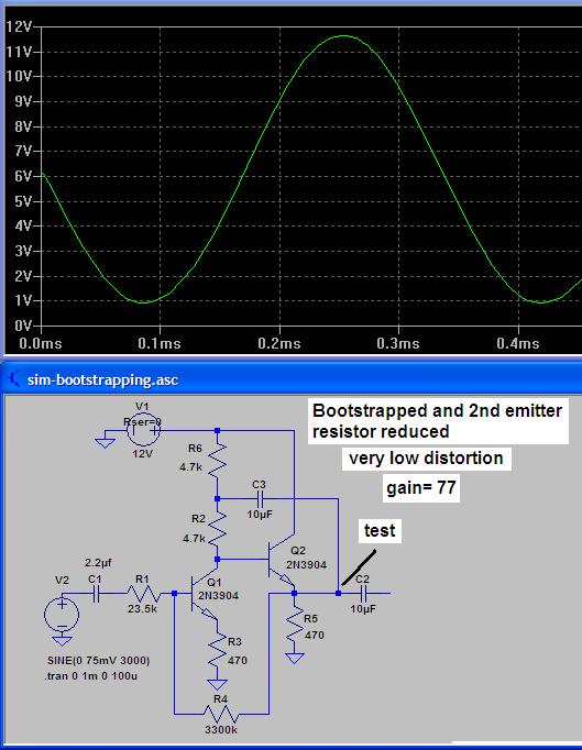

Be interesting to see what simulation says about distortion with and without bootstraping?.
An amplifier design site has nearly the same two-transistors output circuit. It has a gain of only 3 but the distortion with bootstrapping is 10 times lower. **broken link removed**
I made the sim and the gain increases and the distortion decreases at high levels with bootstrapping. The 2.2k emitter resistor for the 2nd transistor has a hard time trying to pull down the bootstrap resistors and works much better as 470 ohms (I didn't change it in my sim).

Here is the circuit with very low distortion because it has bootstrapping and the value of the 2nd emitter resistor is reduced.
