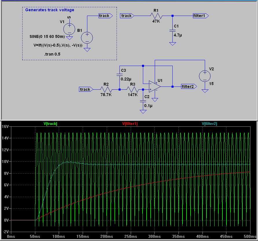

Hi Guys,
I am currently playing with the above 'chip' using a variable DC voltage as an input. What would be the effect of using a full-wave rectified (but not smoothed) and also a 50% duty cycle input? Yes I could smooth the incoming rectified and pulsed input and I suppose whilst on the bread board could just try it and 'suck it and see'. Obviously Values of C and R's would have to be addjusted for required Fout no problem. Any thoughts anyone?
Muso52
It is trivially easy to turn the input opamp inside the TC9400 into a low-pass filter. Because of the high-impedance at the input of said opamp, you can add a second low pass externally with just an RC network.
If there is any ripple present at the output of the internal opamp, there will be jitter in the pulse train output. The frequency of said pulse train is controlled by the DC level. You need to do all you can to make that a DC level; not something with ripple from the external rectifier.
The full wave rectified but unsmoothed voltage is nominally 0 to 12v and used to control a DC motor. This is at a frequency of 120Hz UK mains times 2. I am not sure how the low-pass filter is of benefit.
Ok understand ( I think) I need to condition the above to give me a smooth DC input to the device. The obvious thing would be to use a capacitor however my concern is that the V to F conversion will 'lag behind ' the above when changing levels. Because of the cap I would look at isolating this circuit from the motor drive source also, this device effectively being in parrallel with the motor.Would a simple bridge rectifier be of any use in this respect?

Ok, back to the original question. You can low-pass filter the hell out of your track voltage before feeding it to the VtoF without effecting anything. In fact, if your low-pass filter time-constant matches the acceleration profile of your locomotive, you will actually improve the overall accuracy.
So your saying a low pass filter will remove the 120hz ripple?
Willy
Does a bear crap in the woods?
Two versions of filtering. The opamp version settles much faster.

The easiest way would of course be the use of a capacitor (filter) . However this presents it's own problems.
Of course with respect to time constant matching acceleration that is a no no. We play with the 'throttle' that vary's the applied voltage and hence speed. Said acceleration is related to change in V wrt time.
The input to the TC9400 is in effect connected to the track voltage. The reason for un-smoothed 120hz V is that DC motors ( in models anyway) perform better than if the source was smoothed DC. So unless the TC 9400 is isolated from this voltage the cap would in effect try to smooth the supply to the engine which can draw .500ma to 1 amp depending on load no?. Also the polarity to the the track is reversed when we change direction of the engine. The simplest way of rectifying this would be the use of a bridge rectifier to not only source input voltage but also isolate TC 9400 from track.
With respect to using an op-amp yes great but also similar probs exist. Although we could use a bridge again it would be advantageous to supply the TC 9400 from a regulated supply. Now I am hoping that this will be ok IF I connect ground back to source as opposed to the 'virtual' ground from the bridge. It may work ok, the bridge effectively isolating the op-amp from track supply and also changing polarity inputs when the track feed is reversed.Have I missed anything?
Any thoughts would be welcomed.
Willy
In the RC filter, the capacitor cannot "filter" the track voltage because it is isolated from the track voltage by the 47K resistor. The peak current that can flow ( in either direction) when the instantaneous track voltage is 18V and the capacitor voltage is say 8V can be seen by Ohms law to be I=E/R = (18-8)/47000 = 212uA. Not enough to effect the waveform across the motor...
Everything you have shown will require your "sensing" circuit to share a common ground with one of the tracks. If you want to read the differential voltage across the tracks relative to some other ground point, that can be done, but will require either optical isolation, transformer isolation, or a differential amplifier with sufficient common-mode range to span the offset voltage between the tracks and the sensing circuitry.

Ok, the bridge really is'nt needed but it do'es fulfill one usefull purpose and that is changing polarity of input when it is reversed on track. Providing I go the op-amp route I think I will be ok if, as you say, I share common ground with the track.
