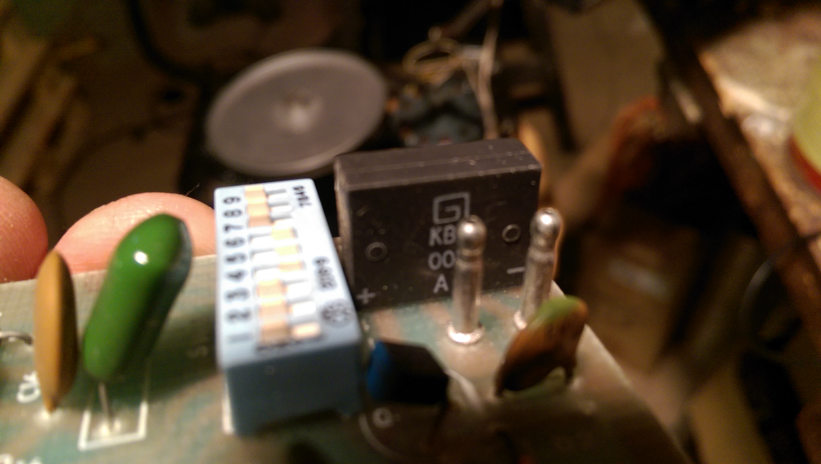

Does anyone know what this component is ? (to the right of the dip switch and behind the prongs) It has 24v AC going in the center and 24 v DC going out on the sides, but when I try to add a device to this power source I get a severe voltage drop. I've taken into account the resistance of the device and it just doesn't add up.

Looks to me like a bridge rectifier.
Ditto, I see a full wave bridge rectifier. AC in center two terminals and DC out marked + and - on the outside terminals. Matter of fact the "prongs" you refer to look to be the AC input to the bridge.

If it says kbpc then its a bridge, fairly sure it is anyway.
If you look at a schematic for a bridge you'll see 4 diodes, you can test each one with a diode test that most meters have these days, you should get around 0.6v per diode, if ones high then it could be open, or maybe one is shorted.
What exactly are you trying to do? Exactly in detail? What is the AC voltage going into the bridge? What do you measure across the bridge + and - out?

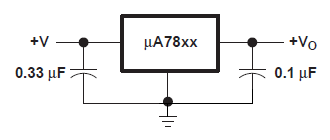

Ok thanks, the 78 series regulator worked on the one project. Although, I couldn't find a 33uf cap. anywhere locally. On to the next project !
Collect and scrounge dead equipment and use a hot air paint stripper to salvage the components off, you'll hardly be stuck again for something.
Oh yes 33uF is a fairly uncommon value, 22 and 47 are more popular.
Why do you need a 33uF electrolytic capacitor with a 78 series regulator? The datasheet shows a 0.33uF ceramic input capacitor and a 0.1uF ceramic output capacitor.
