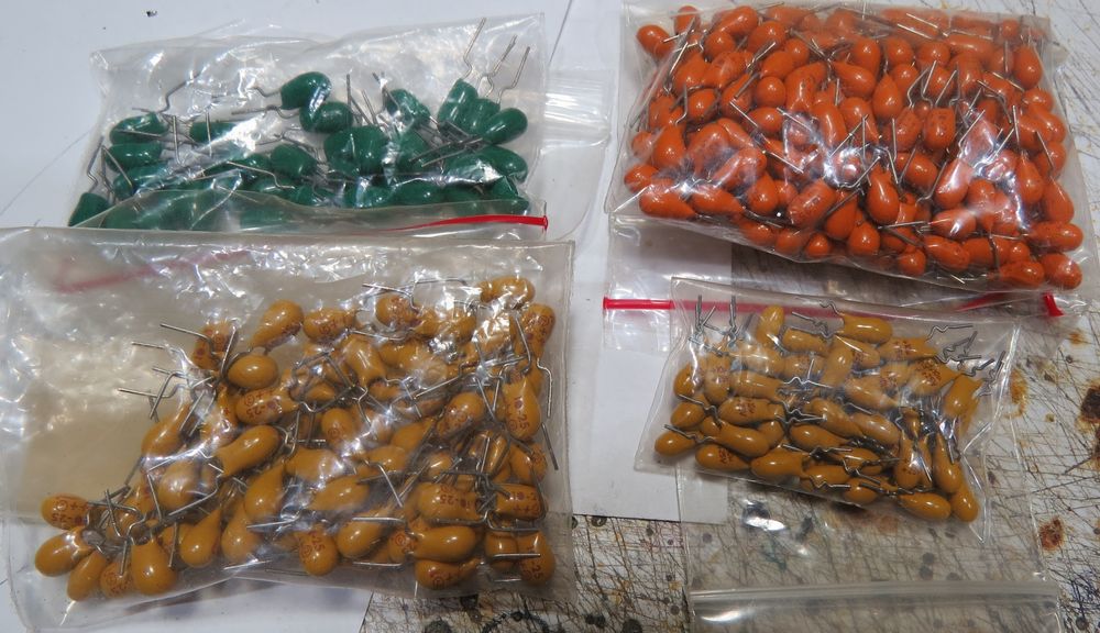

    These are the 10uF, 25V Tantalums I have.
    Been using these for over 20 years and Never had Any of these Fail. The Green Ones have the Best Dissipation factor.

  21. jbeng
    jbeng Member
    Joined:
    Apr 30, 2004
    Messages:
    670
    Likes:
    10
    Location:
    Illinois, USA
    All of those in the bags are brand-new, never-been-used devices. They've not been subjected to [likely] years of power-cycling. In the five years I worked my last job, I never had any issues with any tantalums except the orange-drops. They were the only ones to go incendiary.
