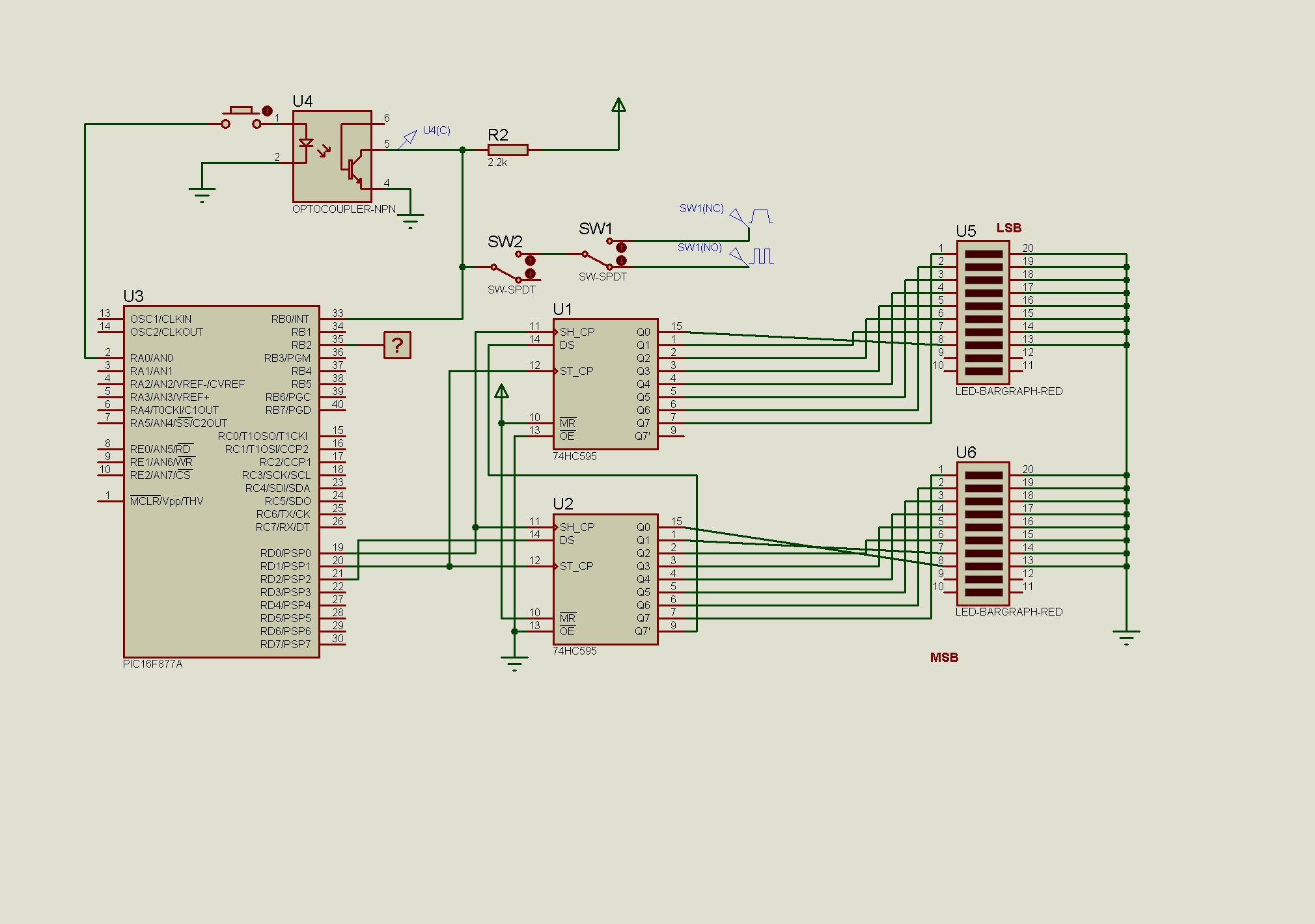

Hey guys,
For some reason this code works in an ISIS simulation but does not work in reality.
I've did some tests earlier by commenting the tachometer() call i get the leds to shift. I also used the testir() function to test the opto interrupter and it toggled all the leds perfectly.

In ISIS all variables are set to 0 by default ( there is a option in micro properties to make the ram random.) change this option and then if it goes "&*$%" up at least you can debug.
Do you have pickit2 or any other ICD? if you do you can run direct from MPLAB to check your code...
Cheers Ian
