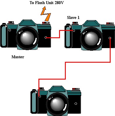

I am not familiar with how this works. So I imagine a master camera which provides flash control to slave cams. Something like attached image. Is this thinking wrong?

I have included a diagram to show the relationship between the cameras, sensor and flash.
The master camera is the slowest to open the shutter. The shutter trips the flash, and the other two cameras will have their shutters already open.
The sensor trips all three cameras, but only the master camera triggers the flash discharge.
MD
If I can delay the flash discharge by a few microseconds, then I should be able to get all of the cameras to see the light consistently.
