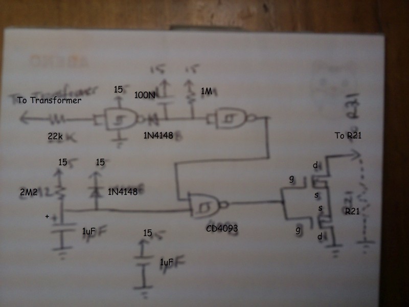

This is a simple amp, has it always done this? - it's probably quite normal, there's no protection against pops when turning ON or OFF (it's common to have a delay circuit that doesn't connect the speaker until after the pops have finished).
I just shorted out R21 and it got rid of most of the pop. There was still some, but nowhere near as pronounced so the main culprit must be the tone stack. Time for a soft start circuitry adventure. Thanks dougy.
Yep it has always done this so I didn't think it was a problem, I was just curious as to how to get rid of it for the learning experience more than anything.
If you haven't come up with an idea for this yet, there's an untested quick sketch attached. Sorry about the quality, my camera's not the best.
The turn-off pop is an easy one to fix. Just connect a relay coil to the mains after the power switch and place the Normally Open contacts in series with the speakers.
It may fix your turn-on pop too because of the 20 ms or so it takes the relay to engage. That's what I would do for starters. Find a relay with a longish pull-in time.
If there are turn-on pops left, I can probably fix that with a couple of JFET's and a dozen or so other parts, but I would need to know what B+ and B- is.
