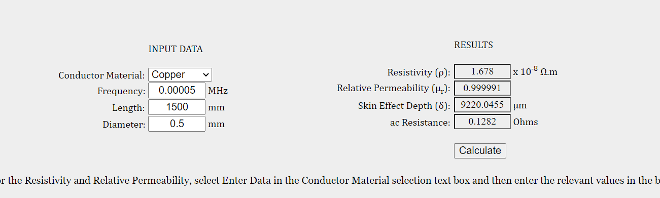

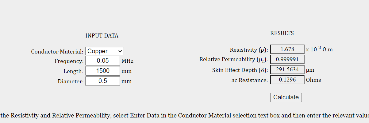

I tried to wind the pulse transformer at 50khz with only one wire to test the skin effect. It must be said that the diameter of the wire was 0.5 mm. So size wasn't that critical. The primary was wound with one wire, the secondary with two. The target power should be 200W. Primary voltage approx. 300V, 39 primary turns, 16 secondary. At full power, all components were beautifully cold, I already thought I had won, but then I noticed that the transformer was 70 degrees. What is the safe temperature of pulse transformers at full load? 70 degrees seems to me enough due to the isolation between the primary / secondary. I did the insulation with electrical tape, so I'm bad at the temperature.

It is important to know if the heat is from the core or the wire. (should be 50/50 more or less)
Where are you measuring the temperature? The outside is cooler than the inside.
Some times I measure the primary resistance cold then hot to get a idea if primary temperature. (resistance change with temp)
Seems a little hot. Might be 100C down inside.
When I got above 50khz I moved to Litz wire.
I measured it on secodary winding. Core outside was cold. Maybe Middle column ? It is probably wire.

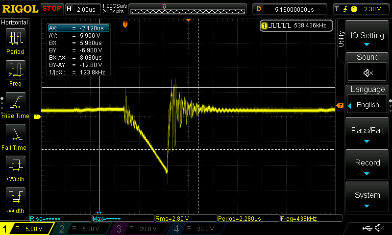

Measured on secondary
aprox Imax = 12A
Duty cycle 17% 50Khz
Ontime = 0.17/50000 = 3,4e-6
area of pulse = ontime*imax/2 = 2,04e-5
Irms = area of pulse * 50khz = 1,02A
Am i right?
Irms (with cursors) = 1,14A

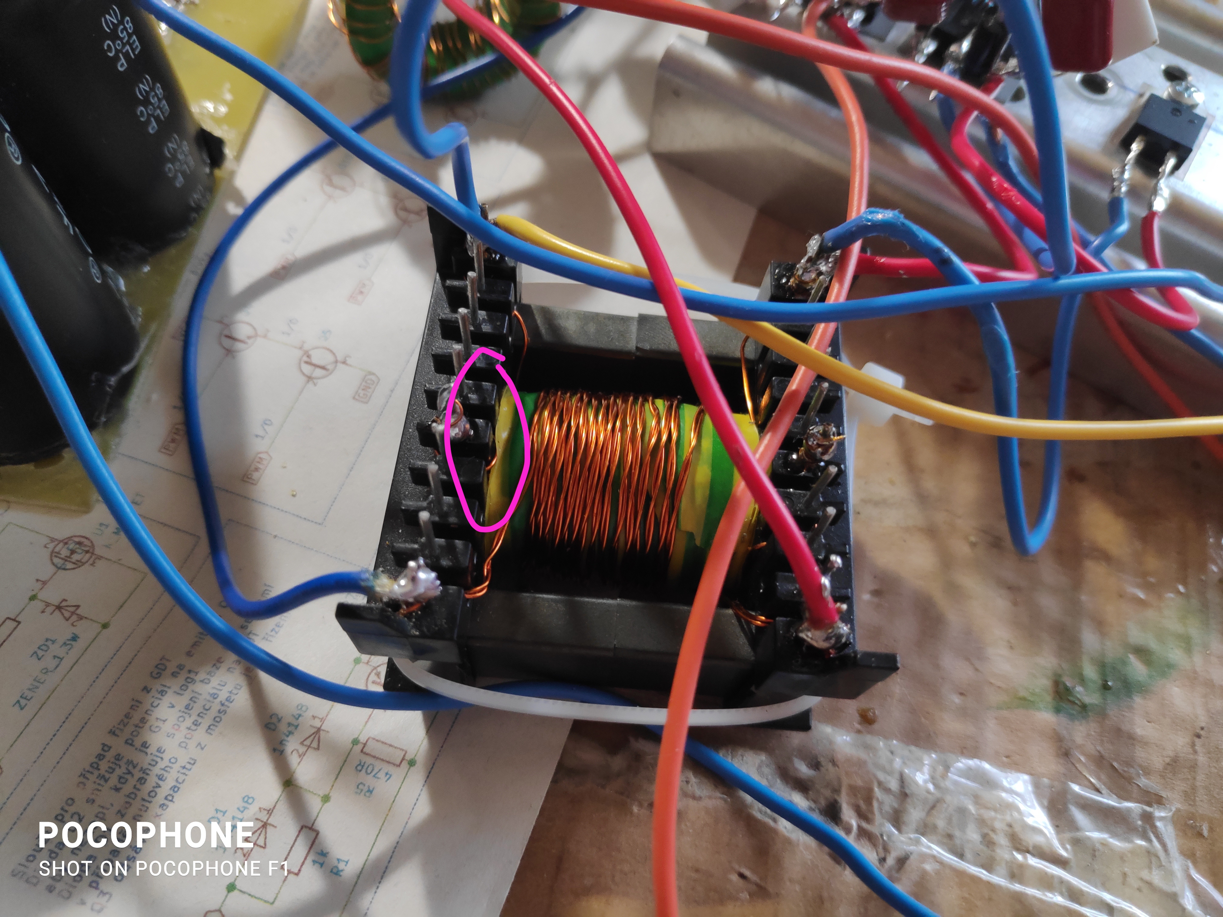

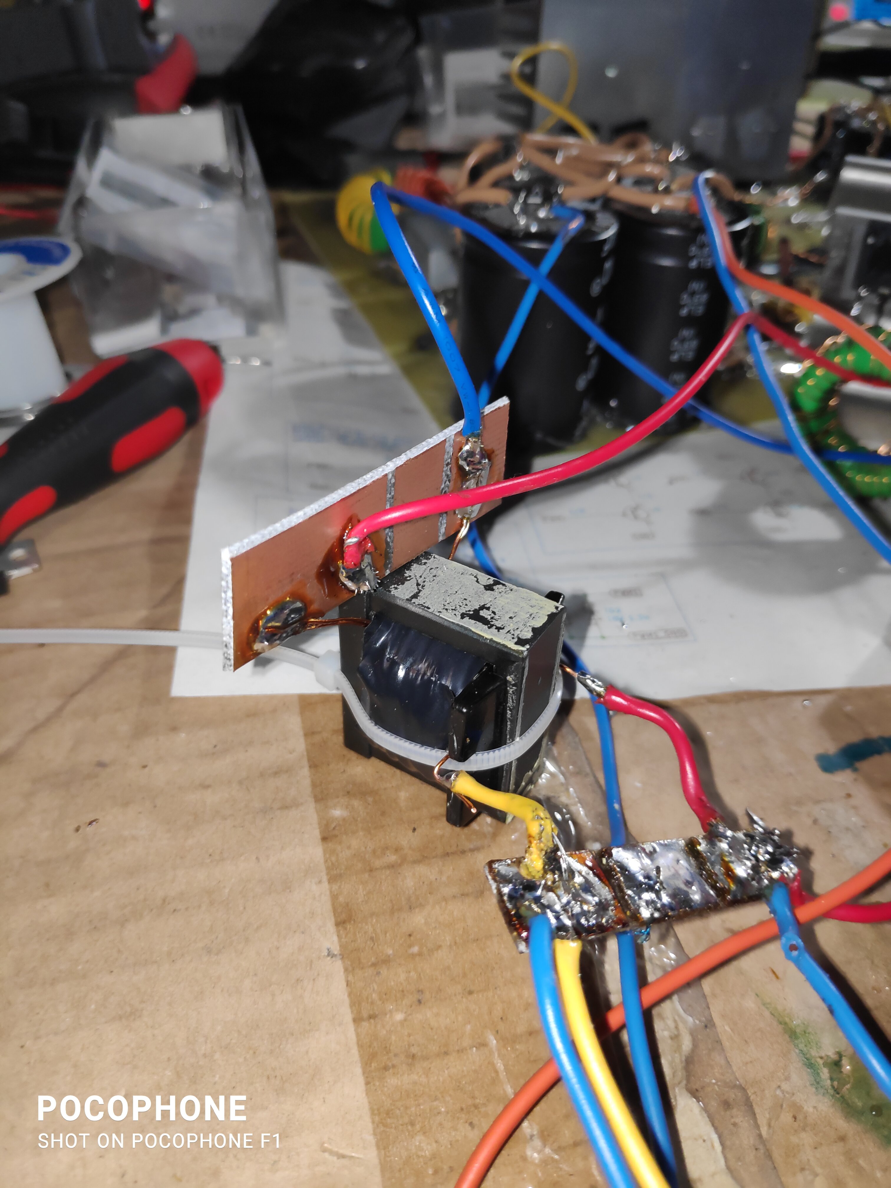

I know of one weak point. The cores are temporarily fastened with a cable tie. They are not tight enough, however, the gap cannot be seen ...
Checker Once again And heat comes from top.
Worth mention that i have unconnected auxilary winding. Its same as primary - 39 turns.
I made another Transformer with same turns primary secondary but i increased frequency to 75khz becouse core Is two times smaller.
This one got even hotter.

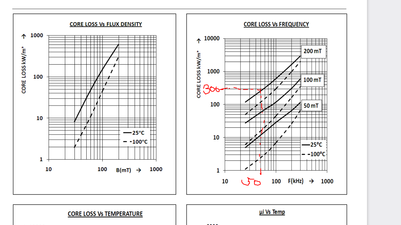

I missed this from post #5: I though its in watts....
200mT is equal to 300kw/m3
Effective volume of first transformer is 0.000 024 m3
0.000 024 * 300kW -> 7,2W
So should i increase air gap?

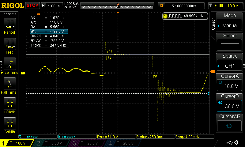

I tried Transformer on lower voltage becouse core losses Are proportional to voltage And frequency. On 75v AC main 75khz 100w way Transformer Also very hot.
I have no idea if Its duel core or winding. But core was Warmer

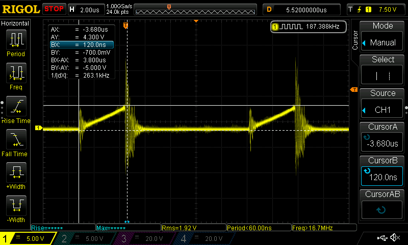

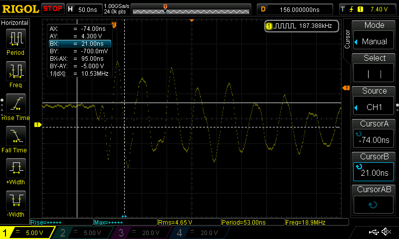

Current on primary side ,second transformer.
Some resonance when transformer should reset.
5A*3,8us/2*75khz = 0,71A
