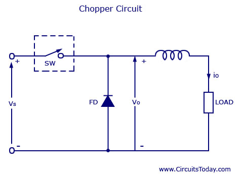

Here's a circuit of a DC Chopper.

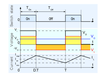

The output waveforms of a DC Chopper (Buck Converter) is as below.
We can see from the images that the output is astable, it keeps changing from 0 to 1. But, yet people call the output of dc chopper as Direct Voltage, as depicted in the image below.
My questions are: 1) How can we justify that the output is DC, when the output is not actual DC?
2) In relation to the case above, can we even call any ossilating square waves as DC?
3) Wont the output voltage keep switching ON and OFF the electronic components connected to it?

The circuit is missing 2 important things, the capacitor across the load and the feedback circuit.
The coil can not increase current instantaneously, so when the switch conducts, the voltage is at the input of the coil while it is still zero at the output. The current increases gradually till the capacitor charges, then the control circuit starts to play its role it it is a PWM or else.
Now the square wave is at the coil input, and during this time the current increases through it gradually building magnetic field, when the switch stops current, the magnetic field decays keeping the current to the load and decaying, there where the diode becomes a must as it provides the current pass to close the loop.
On the other hand, the capacitor will not allow sudden voltage change, so the coil actually compensates for what the load consumes making the change rather softer.
no one says it is clean DC but it includes a ripple of few milli-volts and can be easily be filtered more and more with LC low pass filter
Technically it is d.c., albeit with an a.c. ripple on top
well, arguably, yes, if a square wave is all on one side of 0v - i.e. the current always flows in the same direction - then it is d.c - even if it falls to 0 at times.
no. The coil should keep the current going via the diode when the switch is off. In a real buck convertor with capacitors the current through the load would be much smoother

tvtech, that was a simple answer. But i wonder, why none of the circuit on internet (search term 'dc voltage chopper circuit') show those cap and diode. Well, even i felt the same while analyzing the chopper. One correction, DC choppers have DC input and DC output. Can you get me a practical circuit from anywhere?
Maged mab2
If i'm right the flyback diode excites the load due to back emf. Doesn't it mean the polarity of voltage is reversed? We can't find that happening in the circuit.
There's often a misconception about back emf. It's the voltage on the input (driving side) of the inductor that reverses when the input source is opened (which causes current to flow through the free-wheel diode). The output polarity remains the same.
If you follow the current through the inductor you will see how this works. The inductance acts rather like inertia to keep the current flowing once it is started. For example if you apply a plus voltage to the left side of the inductor then the current will flow through the inductor left to right and generate a plus voltage on the right (load) side also. Now if the switch on the left opens, the inductor will try to keep the current moving in the same direction. This means the voltage on the left side will go negative (back emf) until the diode is forward biased, keeping the current flowing (at least until all the inductive energy is spent). This means the voltage on the right remains positive.

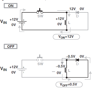

Jony130, I read the page 22 and following portion of that topic. (Img 1.3 inductor), i.e., Inductor circuit's corresponding waveforms has a cross mark. I didn't understand what that signifies. I also didn't understand how there would be a current when switch is open.
BTW, how did you find that book?
You have cross marks because this waveforms are wrong. Author show correct one on imag 1.6 page 31.
Start reading from page 22 and read at least to 48.

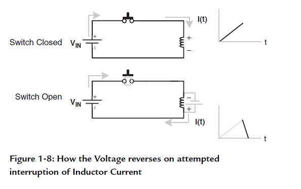

It is a reverse voltage but remember that voltages are relative. Voltages to ground from each end of the inductor are different than voltage across the inductor. As I noted the voltage (to ground) does reverse on the switch side of the inductor. That's the "back EMF". But the current direction is unchanged. The resulting inductor voltages are the result of the inductor's resisting any change in current flow. When the switch is ON the inductor current is increasing and the inductor is storing energy (the voltage across the inductor is plus-to-minus left-to-right). When the switch is open the current starts decreasing and the inductor is supplying energy (the voltage across the inductor is now minus-to-plus left to right). But in each case the inductor output voltage remains positive to ground because the current flow is always left to right.
crutschow, How can the direction of current be the same, if the voltage is reversed? I'm not getting it. You see.
---- [Inductor]---- Current Direction: ------->
How?
You have all the answer in pdf
An intuitive (but not necessarily rigorous) way to visualize it is shown in Figure 1-8. Here
we note that when the switch is closed (upper schematic), the current is shown leaving the
positive terminal of the applied dc voltage source — that being the normal convention for
describing the direction of current flow. During this on-time, the upper end of the inductor
gets set to a higher voltage than its lower end. Subsequently, when the switch opens, the
input dc source gets disconnected from the inductor. But we have just learnt that the current
demands to keep flowing (at least for a while) — in the same direction as previously flowing.
So during the switch off-time, we can mentally visualize the inductor as becoming a sort of
“voltage source”, forcing the current to keep flowing. For that reason, we have placed an
imaginary (gray) voltage source (battery symbol) across the inductor in the lower half of the
figure — its polarity in accordance with the convention that current must leave by the
positive terminal of any voltage source. Thus we can see that this causes the lower end of
the inductor to now be at a higher voltage than its upper end. Clearly, voltage reversal has
occurred — simply by the need to maintain current continuity.
?temp_hash=8e32c722f26f72a9371bde5e714ef00c
This example show that current through inductor flow in the same direction. From upper end to the lower end of the inductor.
When the switch turns on, it puts voltage on the left side of the inductor. This voltage is higher than the voltage on the right side. Because of the voltage difference, the current through inductor strats to increase, but it doesn't increase immediately as it would with resistor, but rather does it slowly. Eventually it would go up as if the inductor was a resistor, but well before this, the switch turns off.
When the switch turns off, the diode puts low voltage on the left side. The voltage is lower than the voltage on the right side. Because of the voltage difference, the current through the inductor starts to decrease. If it was a resistor, the current would drop immediately (and would reverse if not for the diode on its path). However, with inductor, it doesn't happen immediately. It rather starts decreasing slowly. Eventually it would totally disappear, but well before this, the switch turns on.
