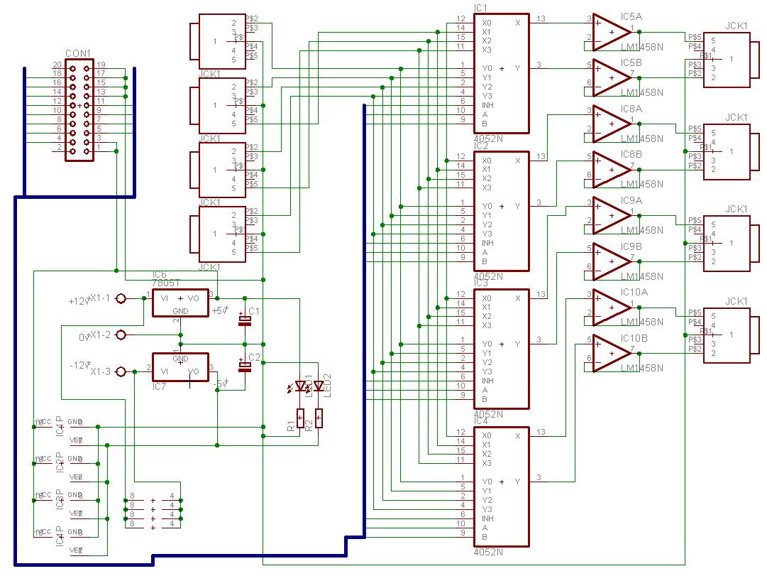

I'm trying to build a small project that takes 4 line level inputs from PC soundcards and outputs to one of 4 outputs (2 sets of PC speakers, line in to a hifi amp or a pair of headphones).
I tried the basic switching of audio using CMOS chips with a 4066 which works well, now I want to be able to buffer it so that 1 source could drive any amounts of outputs needed without causing any loading issues. However I don't know whether the opamps should be setup as amplifiers or just as voltage followers.
I drew out this circuit, its pretty big and complex because it contains some power supply circuitry and the muxing. I also don't know if I need any input resistors or anything so the sources 'see' a load?
If you can have a look for me and tell me that'd be great and I can work on a new drawing.
both configurations can be used . if u don't need amplification use the follower config:
OK, but if I was to connect it up like so and connect up all the PCs and stuff, would the opamps be able to drive the line level audio for all of the different outputs? What if I set them to all use the same source, would the source have too much current drawn from it?

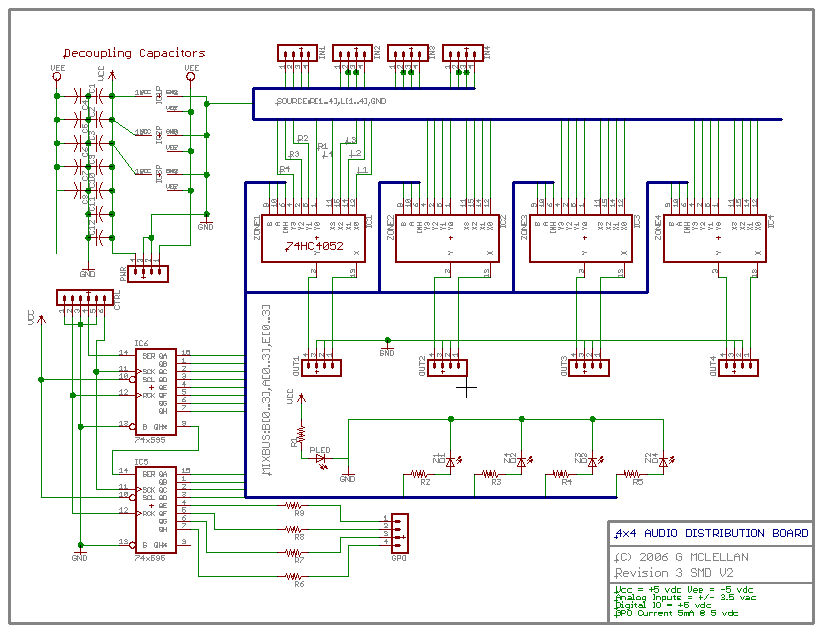

have you tested just using the output stage of your 4052s as the buffer?
i am working on a similar project... 4 inputs and 4 outputs... and had no problems with my initial breadboard testing.
oh, and how did you decide on a 10 volt supply? I went with 10 volts too, really just as an arbitrary number, seeing as how we're only dealing with millivolts here?
here's a bit of my ramblings:
https://projects.dimension-x.net/archives/category/project/audio/

Hi, I have tried it yes and it works fine, but I'm worried that if I want to play the same source on say 3 different outputs, it will load the source too much.
Your project looks really nice and rounded though, I want to get some PCBs made up for this project definately and its gonna have to be double sided! How do you get on with SMD? I'm kinda scared to design a load of boards to use SMD and find its a bollocks of a job to solder and I end up ruining lots of stuff....
I haven't had those boards fabbed yet ... the project is still on a breadboard, kinda got distracted from it ;) I originally thought I'd be fabbing this in house, but when I counted the number of vias I had used, I knew that wasn't going to happen!
all the smd parts I used are fairly chunky, so I plan to just hand solder them. you shouldn'd fear smd, in my opinion having to take a little extra time to make sure the pads solder clean is worth it instead of having to drill countless holes for TH components.
Don't use a lousy old 1458 dual opamp for audio. It is noisy, distorted and has a bandwidth only to 9kHz.
Use a TL072 dual audio opamp and it will work much better for the same or a lower price. Because it is wideband, it will need a 100 ohm resistor in series with each output so that cable capacitance at the output won't cause it to oscillate.

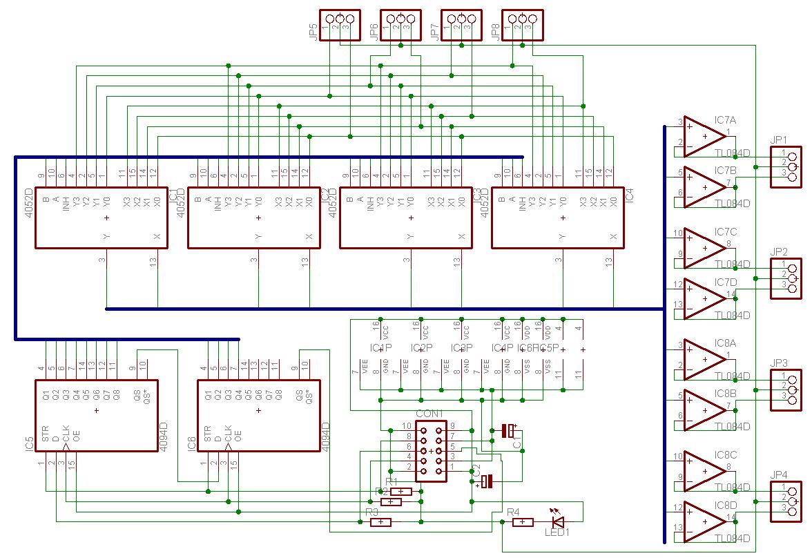

Audio makes a good point, the 07*/08* series is much quieter and generally better. But seeing as your using quite a few, you'll save having to make so many power connections and board space by using the 074 or 084 quad versions. I bought 10 x 084 a while back, totalled £4, so a mere 10p per op-amp.
Ok well I did a bit of redoing and taken into account what everyones said. I'm still not 100% sure on the need for the opamp buffers but I don't want to overload my sources!
Here's an update schematic, I think it's doing everything I need it to, then I just need a controller board. I've resorted to headers for the inputs and outputs to allow me greater flexibility (ie, cascading outputs, different types of connector, etc).

sure, shoot me an email and I'll send the sch and brd in a zip (my addy is at the bottom of every post)... I've got a bit newer version than what's pictured... I optimised it a bit more based on my fab house DRC specs, and added ESD protection diodes to the inputs.
I'm still confused about the op-amps idea (and a little concerned regarding my design).
I get the need for an amplifier if headphones are used, since they're not a high impedance input like a line input would be on a set of powered speakers or a stereo receiver. Is this the root of your op-amp based design, sort of a pre-amp for headphones?
My design is going to be feeding high impedance line-level inputs only, no headphones or un-powered speakers... the input sources will all be line-level outputs from sound cards and perhaps a line-level feed from my cable box.

That would be difficult in that the 4052 has no output stage and can't do any buffering. It's just a switch. Straight wire with a small resistance, bidirectional.
A CD4052 is not a perfect switch. Look at its datasheet to see how much distortion there is when it is on if it has a low impedance load (even 10k) and/or a low supply voltage.
When it is off it is a small capacitor that can couple a signal into a very high impedance opamp's input.
What keeps the input of an opamp from going crazy when its input CD4052 switch is off? The opamp's input will be floating and becomes an antenna for interference pickup. The opamp needs a resistor at its input to 0V.
Well, I was thinking that the opamp would get over the problems with the resistance to the switch because it can probably drive an output better than the source directly. I dunno thats why I was asking you if it was needed :)
