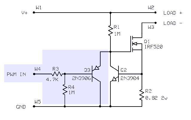

The gate really is not on well at 5V G-S. Then the source is at +0.6V so the gate could not get above 4.4V. I think you need a "logic level" MOSFET.
Problem is to get one of these locally...:(

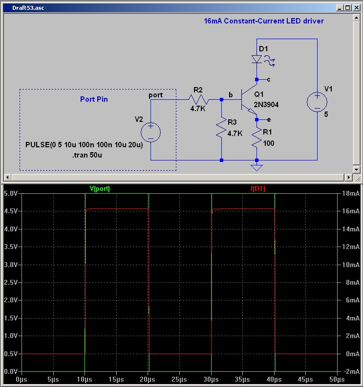

Here is how I would do it. Note that the emitter follower is a constant current source and switch in one. This will work provided the forward voltage drop of your Green LED is 3.2V or less. You likely have a 2n3904 or an equivalent...
Before I buy components, given the circuit (attached) could I go away if Vcc is just 5V, replacing the MOSFET with a 2N7000?
You can just use another NPN BJT transistor in place of the MOSFET; then you don't have to worry so much about the Vcc. R1 will have to be decreased appropriately.

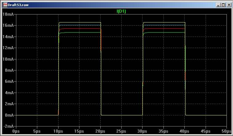

Atferrari implied the logic levels are indeed 0 and 5V in his first post. I was banking on it being a Cmos output like a Pic pad. Lightly loaded (base current is only a few hundred uA, that will put out close to 5V.
The Vbe will not vary enough to make much of a difference compared to the Ve of 1.6V. Here is the LED current at -20 to +40degC in steps of 20deg. -20 is green....
How did you calculate 15mA to 20mA at the output in your circuit with the high power Mosfet?
The base-emitter voltage of the 2N3904 at a low current is 0.6V at room temperature. Then the constant current at the output is 0.6V/0.82 ohms= 732mA and a little LED will blow up!

Sure this is for higher current. I did not calculated actual values for 15 to 20 mA yet.
My concern is to define a valid MOSFET (for my smaller current) that I could obtain locally.

There has been some talk of using only bipolars rather than a MOSFET and that might be fine too, but if you still want to use a MOSFET then that 1M resistor is probably far too large, if that schematic is still valid. 1 Megohm is too large to charge up the gate of the MOSFET if the frequency of the PWM is higher, but even with lower frequency PWM i dont think you want that high of a gate pullup because it will take too long to turn the MOSFET on. Maybe at the lower level current it will be ok, but it would probably be better to decrease that resistance significantly. If this is battery operated you may want to think about this more carefully but if not a lower value would be better in most cases. Remember that the equivalent gate capacitance has to charge up before the MOSFET will actually start to turn on, so whatever value resistance is in series with that capacitance determines how fast the MOSFET can turn on, and this is always something to consider with at least some care.

May be I don't understand something. With R2 at 0.82 Ohm, looks the circuit is aimed around 750mA continuous current (certainly too much for 2N7000). But atferrary says it's 15-20mA?
