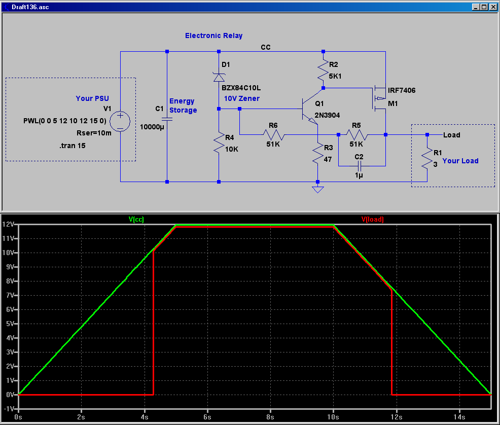

I would use a bistable to switch the gate of the FET so that the FET turns on with a "snap", rather than just the simpler Zener circuit which has rather a soft knee. That will prevent the FET from heating, and minimize its heatsinking requirements.
OK, here is a circuit I call the "electronic relay". It allows the PSU to slowly come up, charging the capacitor as it goes. No current is flowing through the 3Ω simulated load. When the capacitor voltage reaches ~10V, the bistable switch turns on with a nice snap, dumping the capacitor into the load. From that moment on, the PSU delivers the running current. When the PSU turns off, the bistable switch turns back off as the voltage decays below ~8V.
You can use this a place to start. Look at your local suppliers to see what PFETs you can buy there. Write back with the number of something you can find. You are looking for one that has a Vds of >25V, an Id >10A, Vth of -3 to -5V with an On resistance of a few tens of milliOhms.

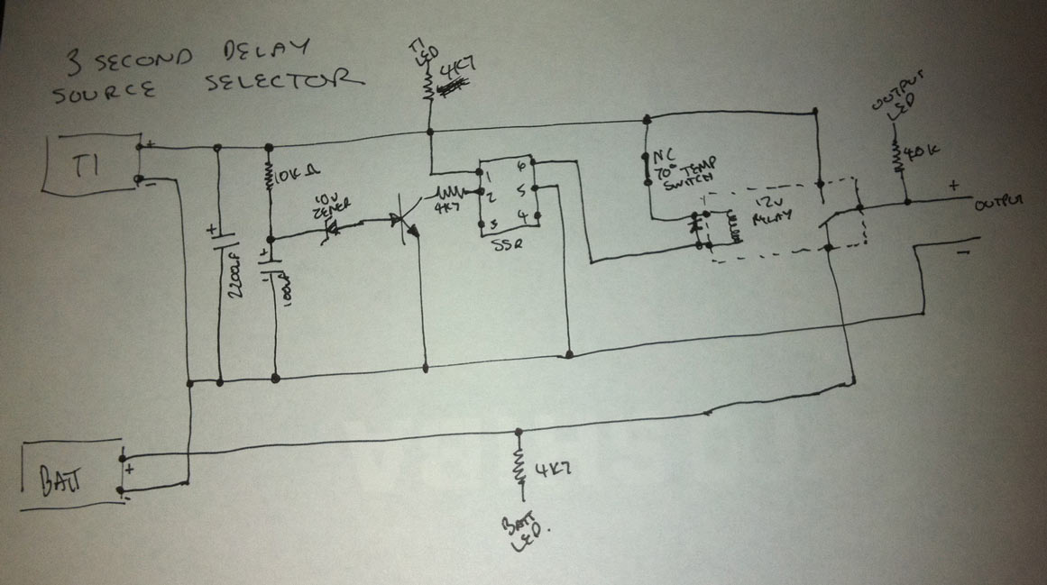

Mike, wow thats a neat circuit. I did however play with a quick Idea I had its very basic ~3second delay. I've uploaded a pic, let me know your thoughts. It should provide a 3 second delay upon startup so the transformer can get its act together and the 2200uF cap can be charged before the transistor fires the SSR and then in turn the Mechanical Relay. I had to put in a basic SSR to get a solid on / off. Would this fix the issue I'm having?
Sorry for the dodgey pic, just a quick sketch, I did breadboard this and it works. Well it works with a 12v zener running 13.8v I need to get a 10v zener or similar to get a good 12v source to switch the transistor.

Since you are using the relay, you do not need the SSR; let the relay become the "bistable". Put a variable resistor in series with the coil, and adjust it to set the pull-in voltage of the relay to be about 11V.

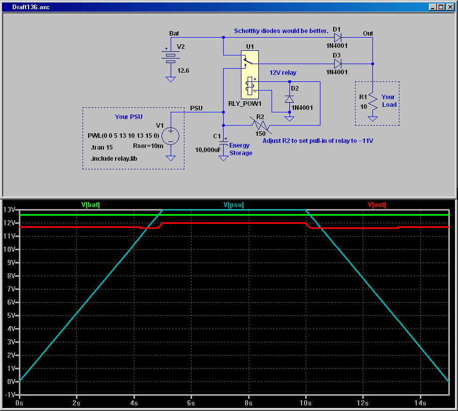

The first circuit is the one I prefer. I use diodes to hold up the load voltage while the relay contacts are moving from the NC to the NO side.

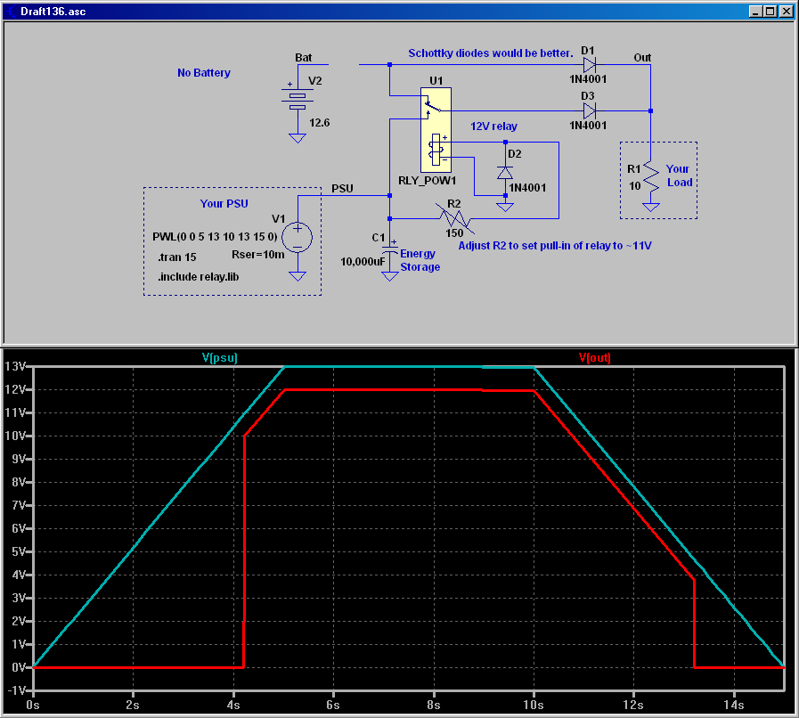

The second circuit is what happens when the battery is missing.

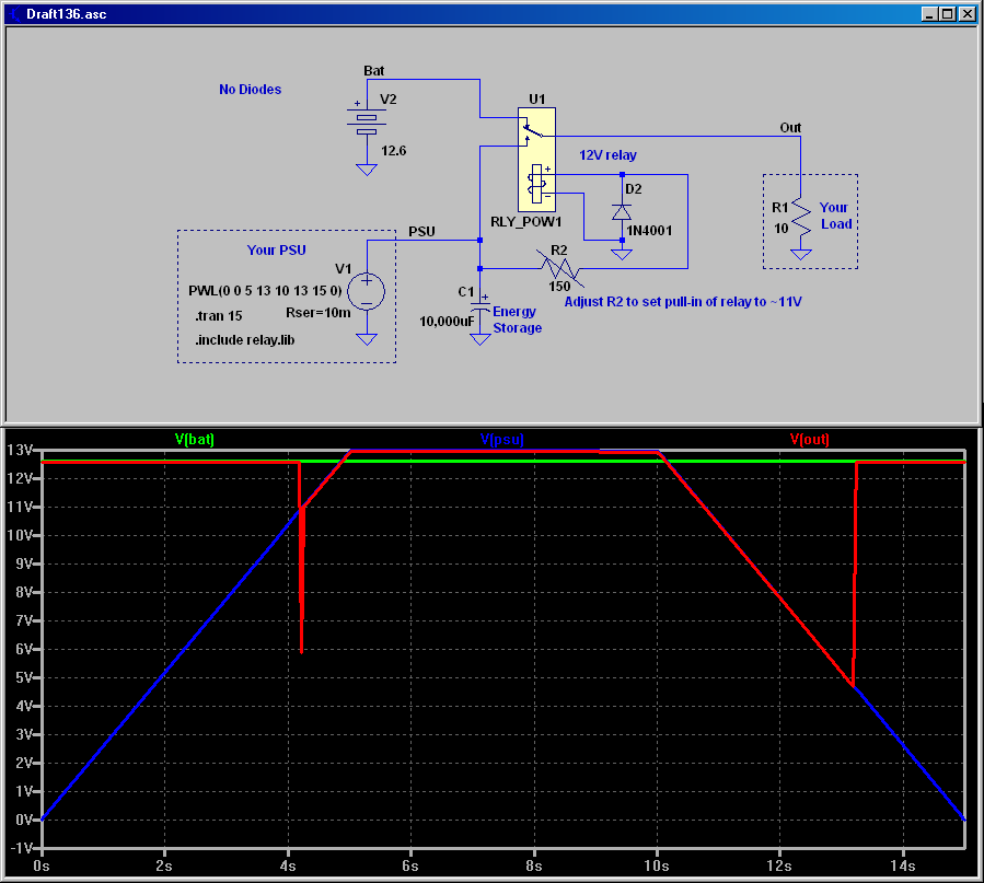

The third circuit is what happens if you do it without the diodes, even with the battery in the circuit.

All of the GND symbols in my (and most) schematics are tied together. Think of the GND as short hand for "tie this to to the common ground point"
Cant you just tweak the PSU so that it puts out 12.6V instead of 12.0V? Use a Schottky in place of the Silicon diode, and that will about halve the forward voltage drop.
I added the diodes to prevent the voltage from sagging as the relay switches. If you dont care about that, then leave them out.

R2 in the schematic only dissipates <100 mW, so almost any resistor will work. I suggest trying 150Ω +- 100Ω. A 12V relay will usually pull in on like 9V, so by putting some resistance in series with it will desensitize it so it takes more voltage to pull it in. If you add too much, it wont pull at all... Find a resistor where it takes about 11V...
Mike, exo! Thanks for that, I have bought a few components I didn't already have to give this a go tonight. What do you think of that Schottky diode I posted a link to? it is a bit of overkill but should do the trick? In fact I should be able to use just one of them too to tie the outputs together and remove that dip in power. Also what is that program you are using to do those charts? looks very cool!
Mike, I was just looking at the schematic here about to build it and I'm wondering about the diodes D1 and D3 you have in there. I can understand that D3 is there to prevent the flow back from the battery into the PSU while in PSU mode. The issue is with D1, it is there to minimise the dip in voltage during the change over to PSU mode from Battery mode but the way D1 is configured it would potentially always be powering the load from Battery? While it levels out the voltage change over it also would simply provide Battery power as well as PSU power to the load preventing feedback from either to the other. This defeats the purpose of the physical dissconection?
I like the idea of feathering out that dip in voltage during the relay cut over but is there any other way you can think of that won't cause the Battery to end up powering the device in either mode? I'll give it a go without the diodes.
