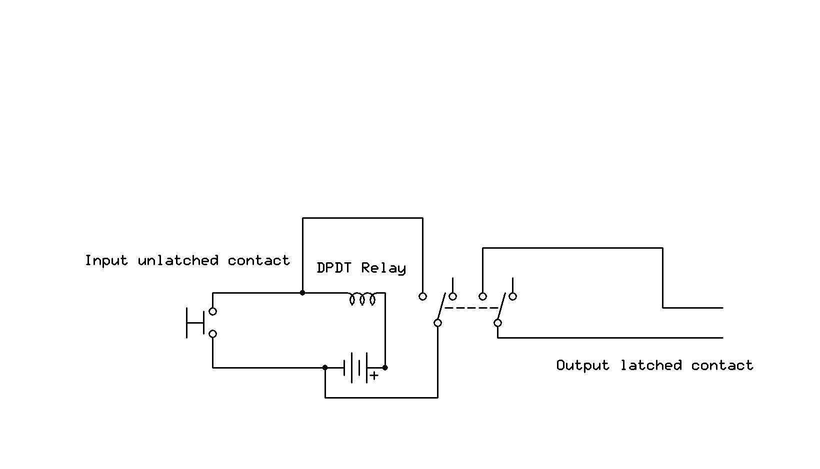

I need to build a switch that normally would be off and when it will be pull to on position it would stay on, even if the switch would be pull to off position.
I mean the position of the switch is off and when for first time it would be switched to on it would stay on all the time,

I need to build a machine (I belive it's called ruby golberg) And my task is to make some circuit that will include few switches that will be normally off and when the ball hit the switch it will switched to on and it will stay on all the time, so I relly don't have to find any way to turn it off jus disconect from the battery.
the switch would be conected to LED so as the ball move foward the next LED would switch to on and so on.

For something a little less dramatic, you can use a latching relay (basically what the previous poster was referring to) where the switch energizes a relay coil and when the contacts close they keep the relay coil energized.
You could build some kind of mechanical latch that keeps the contacts closed once they are activated or just use an inexpensive DPDT relay as wired attached. This will not unlatch unless you remove battery power but it would be easy to add a normal closed reset switch in the battery lead.
