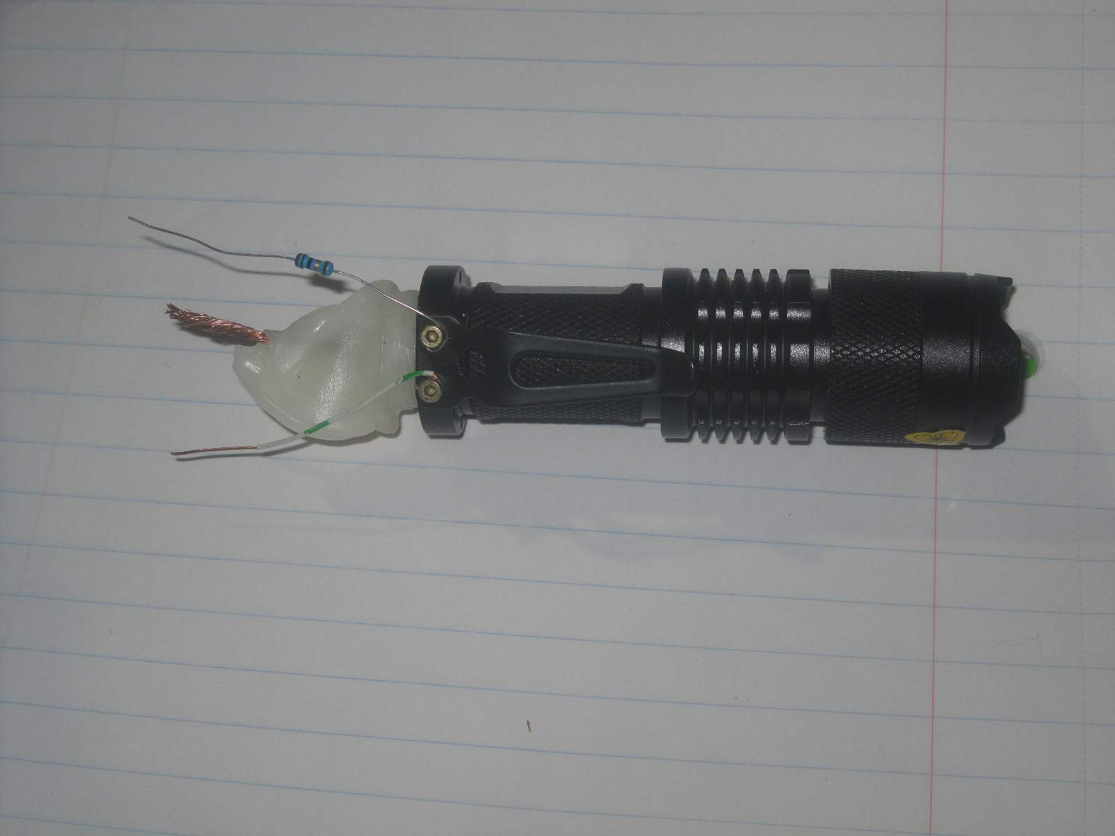

Hello again,
Little update...
I made a simple replacement end cap using moldable plastic. It looks funny but it screws into the end where the tail cap normally goes, and provides one connection, and that is to the negative terminal of the battery inside. There is no case terminal so the case has to be connected to via the two little hex cap bolts that hold the pocket clip onto the light body.
There is a small spring soldered to the heavy wire, and the spring contacts the negative end of the battery when the tail cap is screwed on, just like the original tail cap.
This looks kind of funny as seen in the attachment, but it is just for doing a little experimenting while i look for a small high current switch (2amp rating at least).
Right now the large wire in the center is the negative battery wire, 16 gauge (AWG), and shorting the thin wire from one of the bolts to this wire allows the light to run at full brightness, and shorting the tiny resistor lead to the heavy wire allows the light to run at much reduced brightness with very long run time.
The switch will have to be a three position switch (or better) that connects either the thin wire or the resistor to the heavy wire, and also has an 'off' position.
I've done this with other lights like a home made one with thick plastic body, but the current for this light is much higher about 1.7 amps on full brightness, so i cant use the tiny switches i bought previously.
The down side is the light will become longer once a switch is mounted, unless i mount the switch to the side of the body and run wires through the end cap, and make the end cap shorter. Thanks to the moldable plastic it's not hard to modify the home made end cap. Mounting the switch to the side is not as simple as it sounds either because there has to be a way to stop the switch from turning 'on' when you slide it into your pocket (the intended home for this light).
The way i handled this on another light was to put the switch into the front of the light, where there was a recess so the switch could not get flicked unless you poked your finger into the front and flicked it on purpose. This worked for years. But this light will be more compact. Maybe build up a very small box to house the switch where the switch handle is recessed (a slide switch of course).
The pic is funny but it's just for the initial experiments to see how well the light will function for various purposes before committing to a full modification.
