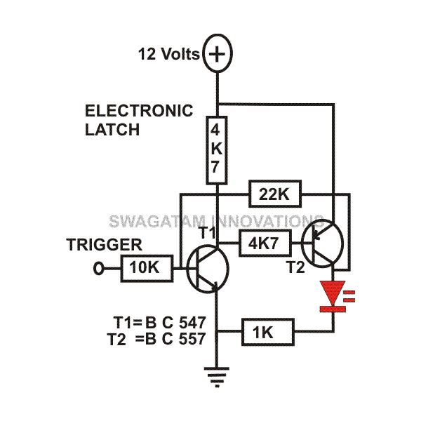

That's what the latch would be for. You can make a simple latch with some resistors and a couple transistors:
Or if you have some JK Flip-Flop chips, you can use those instead.

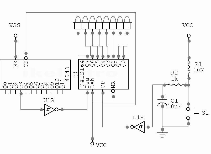

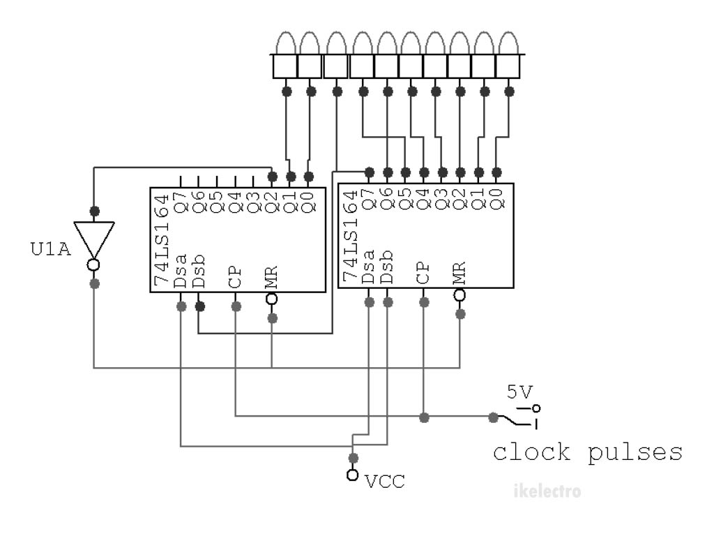

Hi MikeML,
Can the 74LS164 shift register (8-Bit Serial In/Parallel Out Shift Registers) do this???
Yes the chip is capable, but I have not analyzed your circuit.

have to feed the data 8 clock cycle high and then as low????
Take the tenth bit output, invert it, and feed it back to the ShiftIn of the first bit. However, that will run the sequence forever You would also have to force all ten bits to zero initially.
in this circuit I'm able to do what is required but with 8 bits..... please check this......
