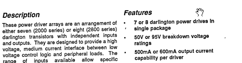

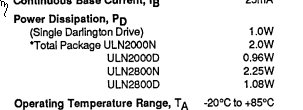

Hi Eric,
Thank you for your comment, just a little concerned that the output is stated as (50V/100mA) is that a max of 100mA as the electromagnet runs at 0.33A which is 330mA of course :)
What's your thoughts?
Scott
As the Velleman guy says in your link to that forum, the 100mA is VERY conservative, if you use only one output from the ULN.
Its stated as 100mA in case you used all the output pins at say 100mA, you could exceed the ULN power dissipation.
E

Eric, you're a star thank you for this detail, i will try this out soon and update the forum post on the result. Just to be clear i should be able to just run just the one component at 0.33A on one output pin as long as i dont add any more components? Thank you
Yes.
I have a K8055, which I have modified and reprogrammed to use a 18F2550.
Checking it visually I see that the ULN is OK for 330mA, but be SURE to connect the PCB clamp pin to +12V ,as per the other forum link.
E
