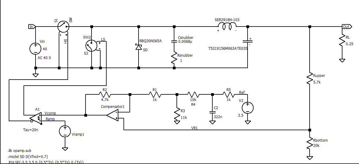

Suppress of EMI in a Synchronous Buck Converter
sers000
Hey,

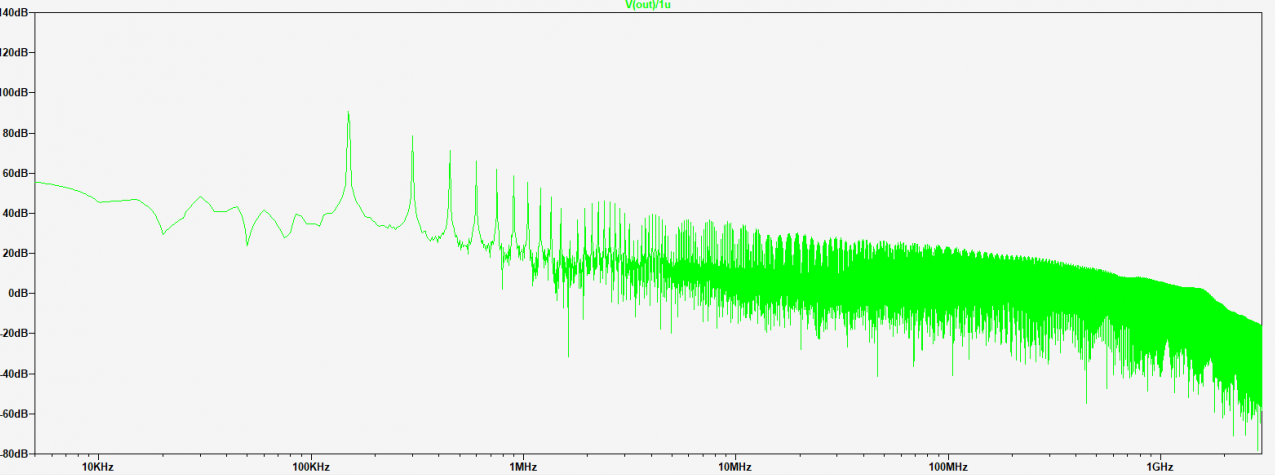

I have been trying to minimize the noise in the circuit. I have applied a snubber consisting of a resistor and a capacitor after the switching components and the ringing effect as a result of switching has been greatly minimized. Now I am trying to minimize EMI levels to a value less than 25dBuV between 10MHz to 300MHz. What methods would you guys suggest?
Currently at the highest harmonic, its at 30 dBuV:
