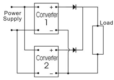

1) Which type of LED driver do I select; Constant Current or Constant Voltage? I am using 4 strings in parallel in which each string has 10 LED connected in series.
2) If I opt for Constant Current LED driver then I have to use current control resistor in each string?
3) As we know 365W LED driver is very hard to get in market, can i opt to go parallel connection of LED driver? i.e. 180W parallel 180W.
Parallel Connection diagram is in attached file.
It would be better using 4 constant current drivers. One for each string of 10 LEDs. What is your reason for configuring them as 4 strings of 10 ? It may be easier to find suitable drivers if you used a different configuration.

Parallel LEDs is not usually done. In the factory we sort the LEDs to get the same forward voltage. Look at the data sheet and you will see how large a range the voltage can be. (usually the minimum is not stated)
You want constant current not constant voltage. or constant power.
