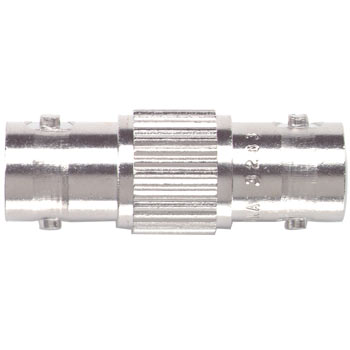

Here is a Pomona BNC F-F adaptor, All-spec has the country of origin of most of its parts, and good quality connectors often engrave the brand and a product number on them. Fairly easy to copy but low quality one's don't bother due to cost, although they could easily counterfeit them, so best to buy through authorized supply chains for the good stuff.
Pomona BNC MM adapter of recent vintage now made in USA.
